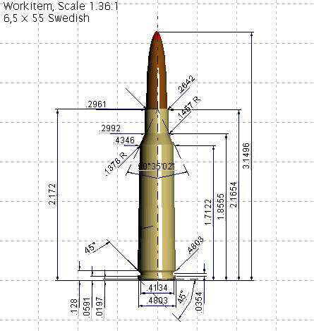

Lore?!?! Er, no.  For your information, I have posted an industry drawing of the proper dimensions of the 6.5x55mm.  Since you apparently missed it all these years, please pay attention to the case head dimension:
Since you are apparently not familiar with these things (despite your years of experience), I will point out for you that the case head dimension is supposed to be: 0.4803"
The measurements you posted in your post below somply CONFIRM what I have stated.  TO quote your post, you stated: " the fired 6.5X55 RP case measures 0.473."
0.473?? It is supposed to be 0.4803.  As I have said (and your measurements confirm) U.S. cases are UNDERSIZED.  Significantly so.  Enough to account for the poor accuaracy of US made cases.  I do not wish to pick a fight with you here; rather, I seek to settle this matter for the benefit of all.  You called my statements "lore."  Since my statements are true, and backed by the very FACTS that you posted, I simply ask you to retract your accusation of "lore."  Regards,

No, you didn't post an Industry drawing.  What you posted was a drawing you found on ??.com.  I am quit familiar with that drawing.  An Industry drawing would have a source, name of the company, date, something to identify the purpose of the drawing.
Why is it that none of the experts have pointed out this dangerous situation?  There are hundreds of sites on the Internet devoted to the 6.5X55.  Here for example
What you are trying to get me to believe is that my cases some how expanded .010 but still didn't fireform to the chamber dimension?  And that normal firing of these undersized cases won't rupture when they are .020 under size?
Point remains.  What proof do you have that Remington or anyone else is using 06 brass as the parent case for 6.5X55.
Give me some facts, not Internet lore based on a drawing you found on the web.

A caution about using diagrams found on the "net".  Here is a drawing of the .223 case.  Note the dimensions of the case head of .377.  Mya cases all measure .371.  How about yours?

Jerr - you are alleging that the diagram above somehow differs from all the other industry drawings of the 6.5x55mm??  I guess you did not bother checking your reloading manuals because any major manual you care to examine would verify that the CORRECT head diameter is 0.4803" - and NOT the very dimension you quote in your own post above: 0.473" for yopur own sample of US made 6.5x55 brass.  You measured it and you posted it (not me).
As for your confusion over  that drawing's source (you called it "??.com."),  if you had simply right-clicked on that drawing, your confusion over it's source would be cleared up.  But since you are as confused on that point as you are on the correct head diameter, then here, I will again do it for you:
http://www.6mmbr.citymaker.com/i/Tech%20Diagrams/65x55.png
6mm Benchrest.  Didn't you say that you use Lapua cases in that caliber?  By calling that drawing into question, I take it you do not trust the dimension drawing of the 6.5x55mm posted by the benchrest guys over at that 6mm Benchrest site? Precision benchrest reloading guys posting falty dimensional charts? Hmmmm - that's strange.  BTW, the Chuck Hawks site you linked in your post happens to lack any case dimension drawings of the 6.5 at all as far as I could tell.
And your post's mention of "dangerous situation" ?? (see below).  Would you care to point out WHERE in ANY of my posts I said anything about "dangerous" ??? Please do not make stuff up.  The only one bringing up "dangerous" is, well, you.  The issue is accuracy, not safety. Many folks I know (particularly reloaders) happen to like both safety and accuracy.  Poorly-made, undersized, US cases will never yeild the same accuracy as European made cases with the correct head dimension.
As far as how Remington is making these undersized cases, I guess you missed my reply to "Fixit" that starts out "Fair enough."
As far as proof? I am happy to use the proof you supplied: undersized Remington case heads you measured and posted (I believe you).  I'll post your measurements again in case you forgot: you wrote: "and the fired 6.5X55 RP case measures 0.473."  Point is, it is supposed to be 0.4803"   Finally, I have to ask you again: (from above):
"Since my statements are true, and backed by the very FACTS that you posted, I simply ask you to retract your accusation of "lore."

I know exactly where 6mBR.com is and spend a fair amout of time there.  Here is a quote from that site in regards to those drawings.
WARNING: Case Diagrams are provided for illustration purposes only. Do NOT use the dimensions on these diagrams to calculate pressures or internal ballistics. Measure your actual cases and use the data supplied by the cartridge maker and the propellant manufacturer. Do NOT substitute these drawings for official SAMMI or CIP specifications.
Do NOT use these diagrams as the basis for creating reamers or tools. Actual production brass may vary slightly from these measurements. It's best to send in actual dummy brass cases when having a reamer made.

You STILL question the dimensions in that drawing? Amazing.
Guess you still have not bothered checking any of your reloading manuals, have you?   Anyone (who's at home at the moment) - care to enlighten Jerr as to what the reloading manuals list as the correct head diameter of the 6.5x55mm ? (Jerr - you might want to remain seated before reading the answers.  Here is a hint: its 0.4803").
Why are you so insistant that the 0.4803" head diameter quoted above is somehow wrong?  More importantly, what makes you think that undersized brass would give the best accuracy?
In trying to prove me wrong, you seem to have lost sight of what the original poster ("OP") asked here, so yet again, I will post it for you: "A friend bought a tikka in 6.5x 55 Swede and has accuracy issues with factory ammo."  Wanna bet that Lapua or Norma cases would "cure" the "problem" ??
Finally, if pointing out your errors by using your own words and facts (repeatedly) somehow puts me on a "high hores [sic]" - well gee, I guess you got me there Jerr!  Never argue with an idiot. They’ll drag you down to their level then beat you with experience.  Jerr - hope you are happy with your undersized brass and the results it delivers (or fails to deliver - for those who expect optimal performance from their guns & reloads - like the OP).  Hope this internet "lore" was useful to you.  I think this thread is done.
