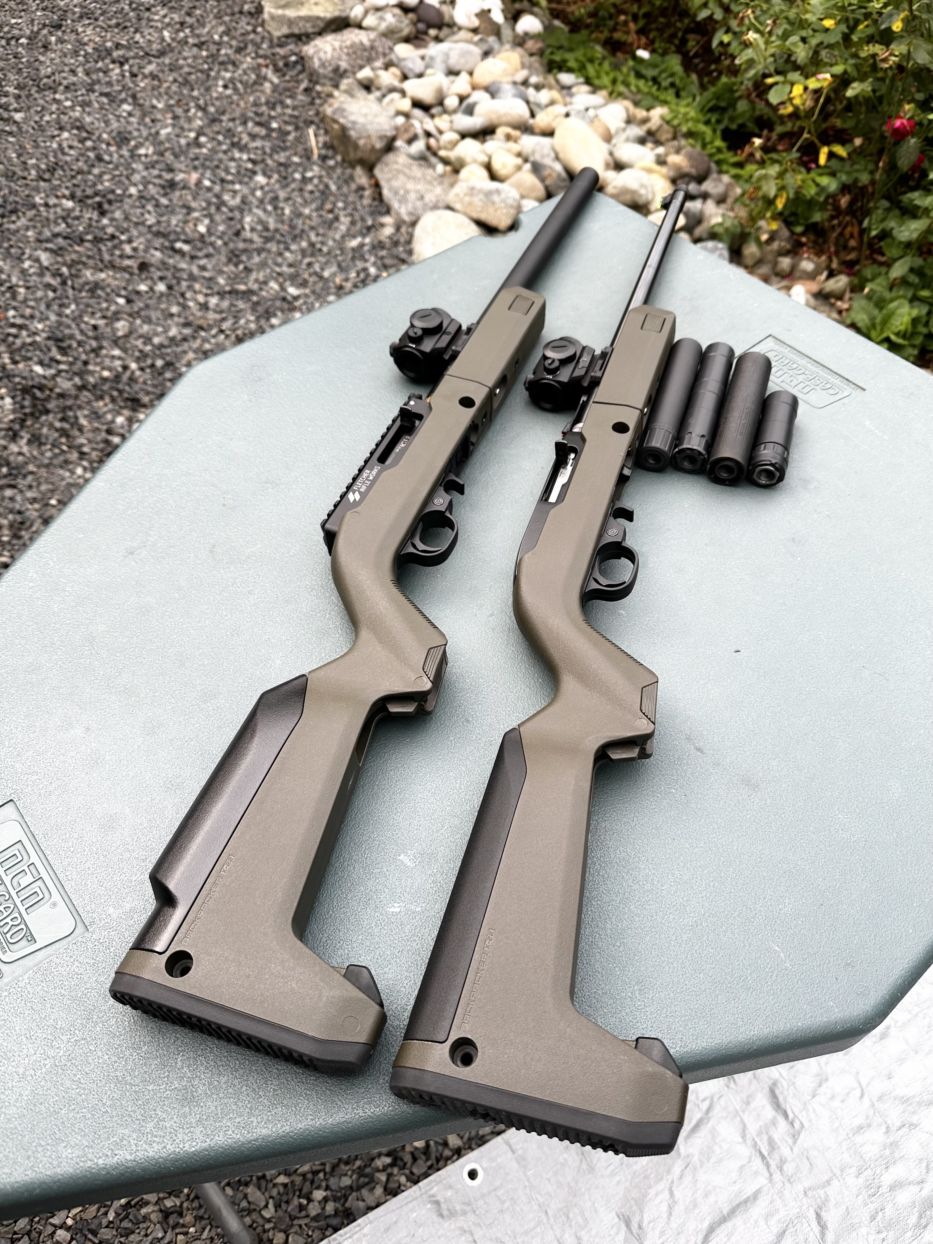

10-22 Takedown,   Threaded 10" Charger barrel.  Rex Silentium MG22. Magpul stock and red dot base.
SBR of course but you could do similar with a Charger and a brace.
I've got the threaded 16" barrel with the same red dot mount.
