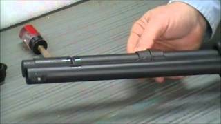

Ive seen the grex leak out of rounds while in the magazine tube and when the operator had a little too much oil / gunk / rain / etc. it gums up in the magazine tube? I'm sure if you replaced the spring you cleaned the magazine tube though.
Do the shells move freely when you insert them or remove them using the shell latch to remove them?  (not racking it?)
Follower or shell getting caught on the seam between the magazine extension? Is it screwed in all the way? Eta, the remington factory extension is actually two pieces, the tube and a collar. Not a lot of people realize that.

I vaguely remember something about drilling out the dimple(s) in the mag tube. I want to say I took a dremel to mine back in 2000/2001 but the directions said to drill it out. Could be that if you just ground them off like I did.
5/13/2026 11:14:09 PM EDT
Usually the 870s that came with the +2 and +3 factory extensions have that metal clip that attaches to the barrel and tube that functions as a sling attach point:
There's a screw that adjusts the tension. If you screw it too tight it pulls the barrel and extension together and creates a seam where the extension screws into the connecting collar. Any chance you did that?  The binding problem with tube extensions often comes from the extension not being true for one reason or another, I'd focus on making sure the extension is straight.

Is your Express magazine tube "dimpled"?
If so your shell follower might be binding at the dimples as shells move from the extension tube.

Dittos on the dimple at extension. Did you replace oem spring to provide for extra shell?
Similar situation I experienced with same type of usage. If shell follower & spring are oem, I would start there.
Also clean & oil mag tube.

As for shells binding in the magazine tube.  Remove the magazine retaining cap, magazine spring and follower.  With the magazine tube empty, point the muzzle down and insert dummy rounds or shells into the back of the magazine tube like you are normally loading it, and see if the shells go all the way foward and drop out the front end of the magazine tube, as they should and this will ensure that there is no blockage of the magazine tube.  If shells bind or get stuck inside the magazine tube, then there must either be an obstruction, dent or bend to the magazine tube.
Now what makes the shells come out of the magazine tube is the magazine spring pushing on the follower, which in turn pushes the shells out of the magazine tube.  So make sure that shells freely move through an empty magazine tube is a simple check to see if there are problems with the magazine tube as I already mentioned.  You already mentioned that you added a heavier spring, I am a huge fan of Wolff magazine tube springs for more powerful feeding.
The follower could be getting stuck or dragging.  This can be attributed to something with the follower like being deformed.  But can also be an issue with heavy debris fouling inside the magazine tube, so you may try using one of the Brownells magazine tube brushes to swab it out.  By cleaning out the magazine tube, you can eliminate that it isn't crud or fouling causing the issue.
As already mentioned, make sure that your magazine tube extension isn't binging up the spring either.
