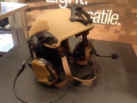

3M/Ceradyne manufacture the Enhanced Combat Helmet which has apparently been issued to a few Marines.
Last year's SHOT Show they showed off various new helmets, including the Extreme Ballistic Helmet that was rated to stop rifle rounds as well, and has a higher cut for headsets.
http://soldiersystems.net/2014/01/15/shot-show-3m-ceradyne/
Still, I don't believe you can actually buy an ECH, and I haven't been able to find any more info about the Extreme Ballistic Helmet aside from that post.
