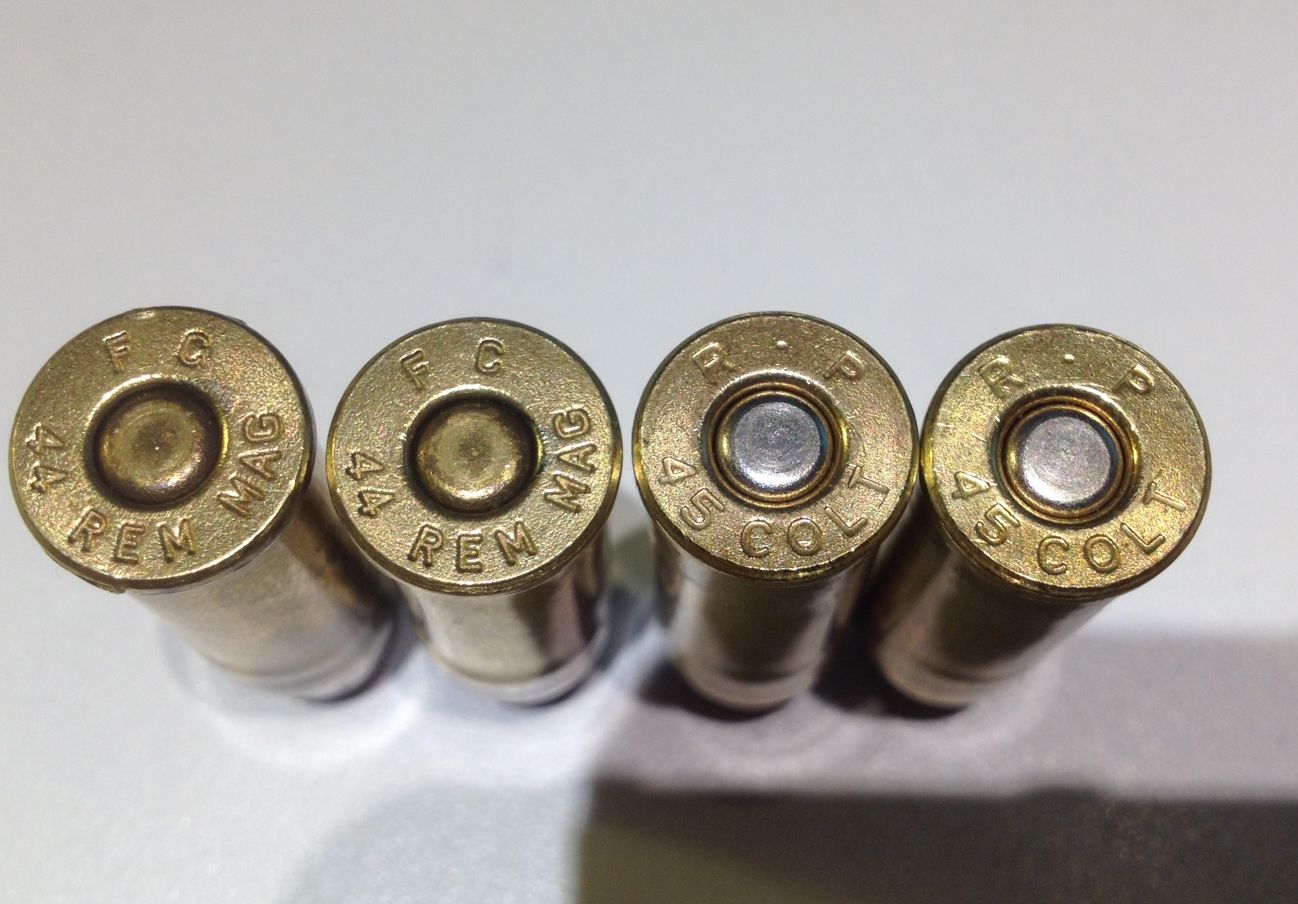

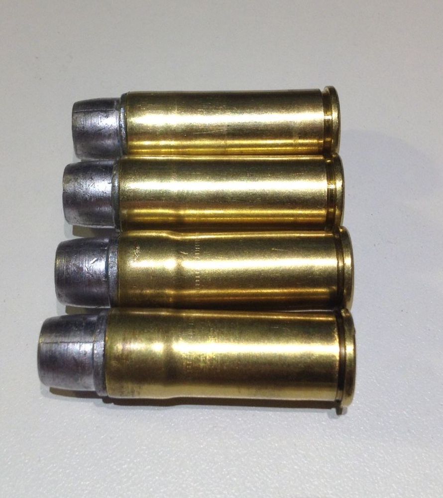

We (B-I-L and I) learned a valuable lesson the other day, .45 Colt and .44 mag cases are not all that different in size. This could have been a big problem if they made it into my rifle.

If those are low powder cast loads it would most likely only split the cases or made them into 45 colts.

They are fairly light loads. 255 grain bullet over 18.5 grains of 2400.
10/13/2014 8:57:24 PM EDT
Ya, that's bad.  44 mag cases are strong. They just might hold up to the pressure. Or they may hold on long enough to build enough pressure to fail spectacularly.

We couldn't figure out why they looked like that until we looked at the head stamp. I guess we didn't sort well after cleaning. We went through the rest of the .45 Colt brass and found a bunch more .44 mag.

I don't think I'll try them in my levergun. I think it would hold up just fine, but I don't want to take the chance. I marked the rounds and put them aside as a reminder to be careful. Also, just to show that I can do stupid things too.

I'm still trying to figure out how you could bell the mouth of the .44 case out to accept an.45 caliber bullet without knowing it!
10/15/2014 7:52:28 AM EDT
I imagine it has a lot to do with the 44 mag brass having already been run through a 45 sizing die.
10/15/2014 8:46:12 AM EDT
44 Mag brass would go through a 45 Colt die with zero effort because it's so much smaller than the inside of the die.

I didn't notice any extra effort operating the press.
10/16/2014 3:02:09 PM EDT
This. It would be like when you run a .380 through a 9mm sizing die.  Feels like there is no resistance.
