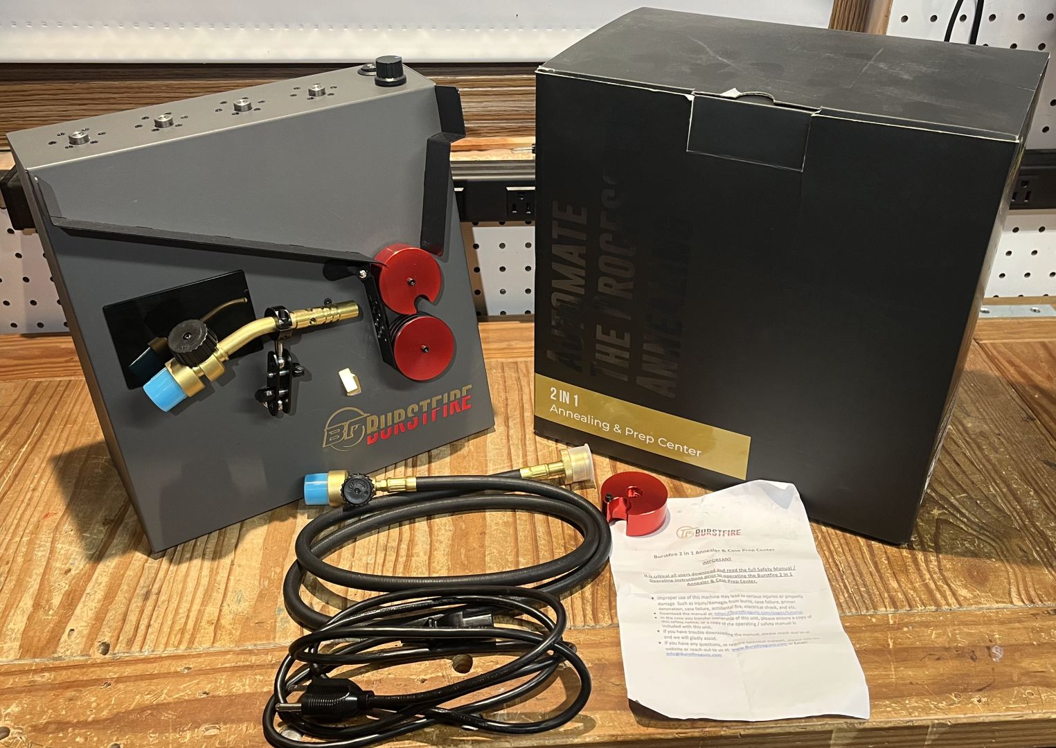

In the box, you get the annealer, torch, power cable, adapter line for 16oz propane cylinders, short case feed ramp, both standard and magnum feed wheels, and a single page manual that points you to BurstFire’s website that contains PDF manuals and YouTube video tutorials. The annealer is manufactured in Taiwan.
Unboxing  the gen 2 BurstFire 2-in-1 flame annealer
The fit and finish of the BurstFire annealer are quite nice. There were no defects in the paint or assembly. The machined feed wheels look nice and are evenly anodized. The silicone looking bands on the feed wheel are superbly grippy and, I expect, will wear well. I unscrewed the back panel on the annealer and it looks quite repairable with a screwdriver and soldering iron, and I understand it is easy to get replacement parts from BurstFire if you have a case prep center motor wear out or something. Overall, the unit looks well designed and manufactured as well as quite serviceable. It also comes with a limited lifetime warranty.

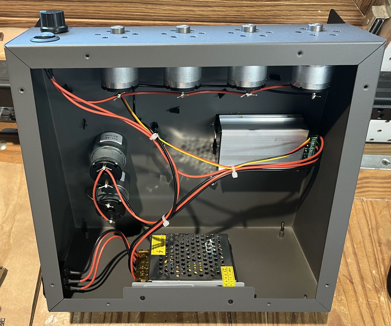

The guts of the gen 2 BurstFire 2-in-1 flame annealer

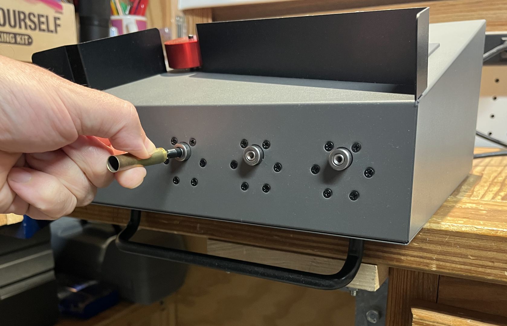

The first feature I used on the gen 2 BurstFire 2-in-1 flame annealer was actually the case prep station so I will start here with that. I have wanted a nice case prep center for a while now. This is mostly because I cut a lot of crimps out of primer pockets and I thought a solid platform might really help keep things steady relative to trying to hold down a case with one hand and line up a drill with the crimp remover in it in the other. It turns out the BurstFire is particularly well designed for this. The carry handle on the back of the unit is intended to act as a stop, to keep the unit from sliding around when it is oriented horizontally on a tabletop. This makes for a solid platform and has just enough overhang from the table to allow whatever shavings your producing or gunk you are cleaning out of casings to fall into a trashcan below. This worked quite well. Another nice design feature is that the rotation speed of the far left motor is about half that of the other three in case you want a higher torque / lower rpm option for one of the tools you’re using. My only complaint with the case prep center is that there is no place for a wrench where the tools thread in the motor, so if they work themselves tight, you sort of have to jerk them loose by torquing them super fast. Overall, I was really pleased with the case prep center and consider it a big added value in the unit.
Removing a primer crimp from 350L brass using BurstFire’s primer crimp remover and 2-in-1 flame annealer laid on its back such that the carry handle makes for an excellent stop positioning the unit to drop shavings into a waste basket

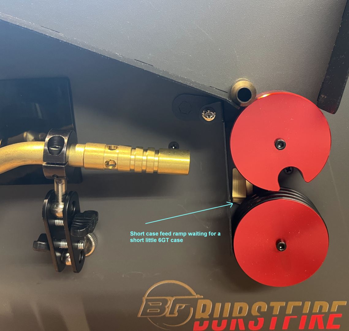

Short case feed ramp in position for a 6GT case
I will add that there are certainly cartridge limitations to this machine as well as likely cartridge limitations to flame annealing in any machine. I think running a cartridge shorter than a 38sp in the BurstFire would be a challenge when it comes to positioning the flame to do its job and not get the wheels as well. There is also some theoretical absolute limit to how short a cartridge can get and you still be able to heat its neck and mouth hot enough with a torch without heating up the case head, which would result in a case head that is too soft to be safely used. Brass is quite conductive and the shorter the distance between the area you are trying to get hot and the area you and trying not to get hot, the more challenging the equation. Lastly, BurstFire sells aftermarket feed wheels for extra small (think 17 hornet and FN 5.7x28) and extra large (Cheytack / 50BMG). No doubt you would want those if running said cartridges, as brass is super expensive. FN 5.7x28 is also well known for blowing out brass shoulders worse than anything else I know of and the lifespan boost you would get from annealing would likely be particularly excellent on that cartridge with annealing.

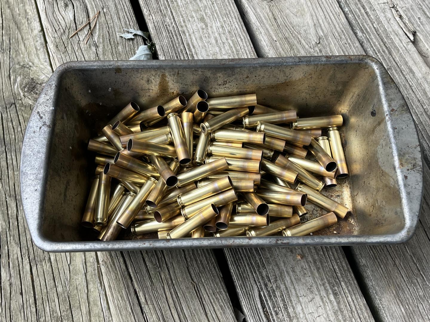

How about my brass though? The bullet seating force after annealing with the BurstFire feels both noticeably reduced and more uniform. As for consistency of velocity and improved accuracy, I don’t have a good answer. If there is difference, you need a lot bigger data sets than I have produced to see it. I did solve, though not fix, that velocity problem I was having though. It just boiled down to a powder simply not being as good a fit as I expected it would be with that cartridge. Having a radar chrono the last two years and therefore firing a ton more shots over the chrono than I ever did before has been an eye opening experience. Of course, the biggest benefit to annealing is case life and I expect my case life will be much improved. We will have to wait and see on that front though, as I don’t think I am near the end on any of the lots I have been annealing.
All finished with the first batch of brass I annealed and removed the primer crimp from using the BurstFire 2-in-1 flame annealer and case prep station

Very nice photography on this review. Must be some of the most professional looking shots if seen in a review here.
I like that you showed the inside of the machine. Interesting they have individual motors for each prep tool. I assumed it would be geared similar to what Hornady and perhaps others use in their prep stations. They are likely individual geared motors to give them added  torque.
