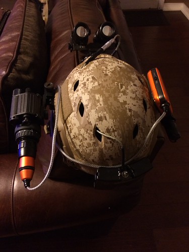

I've been looking for a good way to record night vision video while out hunting, hiking etc. that doesn't require lugging around a DSLR with a dedicated NOD. My ideal setup would be something like the Wilcox MHRS (Mission Helmet Recording System) Wilcox MHRS, but I don't have an extra $6,000 laying around so that will have to wait.
Since I like to tinker, I've been experimenting with a DIY night vision recording setup inspired by some of the features on the MHRS (Modular, helmet-mounted, uses existing NOD), but at a much lower cost. Rather than use my brain and plan things out, I prefer to use trial and error (mostly error) until I find something that works. The camera I'm using is a Panasonic HX-A100
I initially had it connected to an extra PVS-14 which was mounted to the rail on my helmet with a standard weapon mount. I think this setup will actually work pretty well, as long as you have the neck of an NFL linebacker.
My ultimate goal is to use a beam splitter/prism (like on the MHRS) and connect the camera to the eyepiece, so I can dispense with the additional PVS-14. Since I know absolutely nothing about beam splitters and prisms, I spent some time aimlessly browsing through the products on Edmund's optics. I ended up ordering an elliptical plate beam splitter. Since then, CJ7Hawk has alerted me to some much cheaper sources for beam splitters and prisms and has also suggested using a beam-splitting prism rather than the plate type. I plan to order a few of those eventually, but in the meantime I have been fooling around with the one I have.
Last night I built a housing out of PVC pipe and bondo. I was partially able to get it to work, but I need to mess with it more because it doesn't show the full field of view. I removed the splitter from the housing and I'm now using some velcro to experiment with different angles and spacing.
Very nice work! What mini DVR is that, it certainly has a heavy duty cable hookup and minimal chances for getting caught on branches and such. Quoted:
Very nice work! What mini DVR is that, it certainly has a heavy duty cable hookup and minimal chances for getting caught on branches and such. Thanks! It's actually just part of the camera unit. The cable doesn't look as heavy duty in person, but it still seems fairly durable. The camera is advertised as waterproof, albeit only 5ft, but it should at least survive a little rain while mounted on top of the helmet. Quoted:

| Keep in mind that the camera that was posted is just the camera, it does not include a recording device or power supply. As with everything they do Wilcox put a TON of engineering into the recording module and the system itself. That camera also does not have a microphone. The MHRS has one built into the recording module with a remote mic. |

How about a lightning cable to USB camera cable, attached to whatever USB camera has the most promising camera module. Alternately you could buy the iphone replacement camera and ribbon cable, and try to extend the ribbon enough to put the camera on the beam splitter and your iphone in the counterweight pouch. |

Thank you! Yes, the mount was loosely thrown together so there is some movement as I walk around and turn my head from side to side. I wanted to make sure it actually functioned first and then I will refine things a bit and tighten everything up. Yep, the screen is illuminated while it's recording. I plan to cover the screen with an IR filter and will try to find a Bluetooth/wireless remote to control the camera functions. IR Filter: https://farm4.staticflickr.com/3931/15227015630_6a0f2fa6be_c.jpg https://farm4.staticflickr.com/3930/15227155997_8f59215ffa_c.jpg Quoted:
