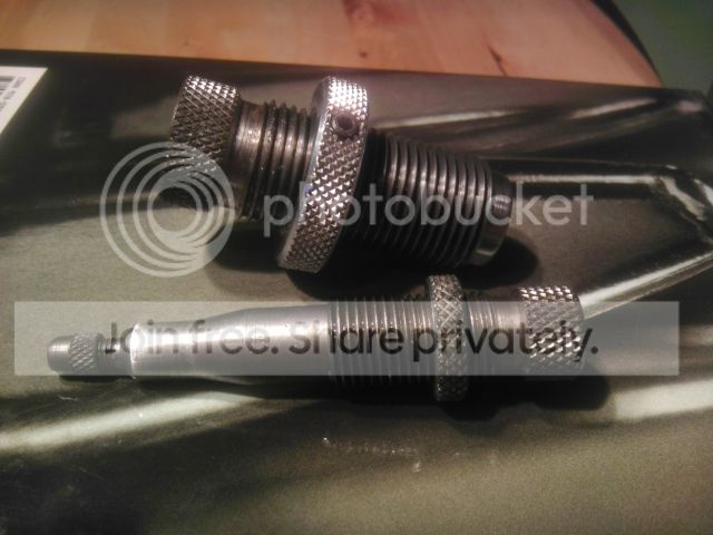

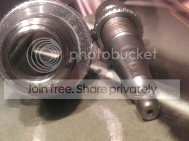

I just went back and looked at the CH-4D site again and, apparently I misread what I was reading before! It's a NECK SIZING bushing system...NOT an expander. I guess the confusion came when I looked at the parts page for their sizing dies and they show expander plugs for them....

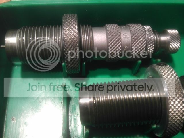

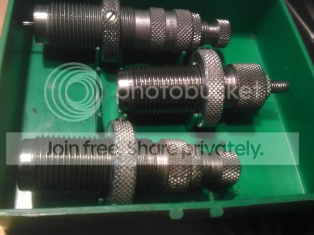

It appears that I have your #2 and #3 dies, minus the decapping pin in #2, and somebody along the way substituted that CH-4D sizer/decapper die for the original RCBS sizing die.
The older RCBS pistol die sets I have are: Die 1. Sizing (no decapping) Die 2. Mouth Belling and decapping Die 3. Seating die. This appears to be the case in your new dies. And, that may have added something to my confusion! My Lee sets all have decapping/sizing in one die and expanding in another. To adjust the belling, on the Lee dies, you move the whole die in/out of the press and with this RCBS die, you move the plug up and down in the body of the die. Oh well, live and learn! And thanks for helping me unconfuse myself! |
