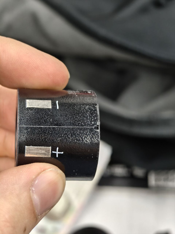

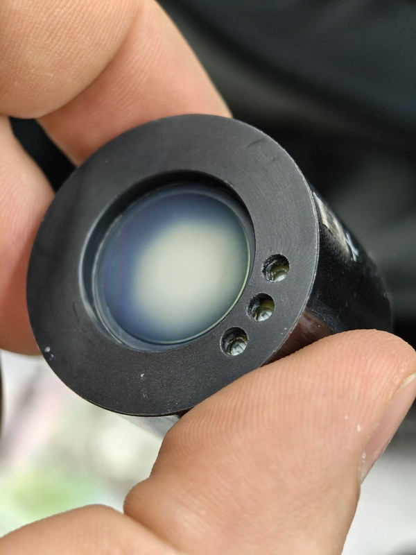

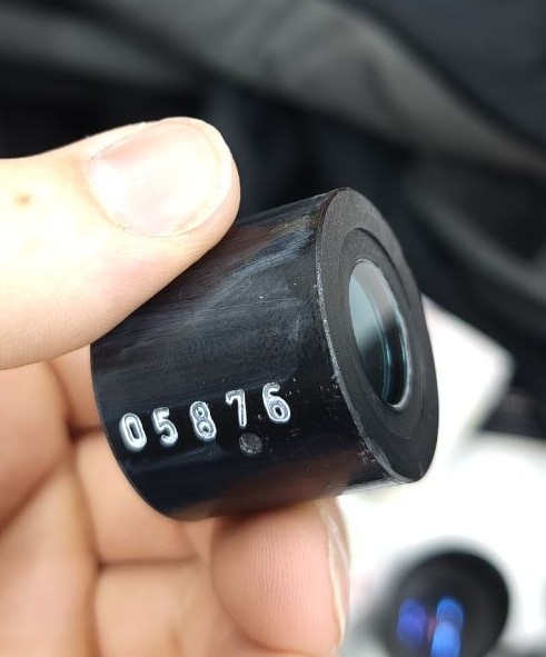

Hey guys, I'm looking for some help identifying an 18mm image intensifier tube. It's a 10160 style format (flat contacts, no manual gain pigtail). There are absolutely no manufacturer stickers or labels on the body. The only marking is a serial number 05876. Has anyone seen this specific housing style or serial number format before? Could it be a Harder Digital?https://i.postimg.cc/2yCn17v9/photo-2026-08-09-20-19-45.jpg https://i.postimg.cc/4NLp3t3c/photo-2026-08-09-20-19-48.jpg https://i.postimg.cc/c49fJYJ2/photo-2026-08-09-20-19-36.jpg |
