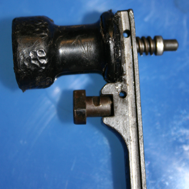

i have one....you're after the pin for the bottom hole in the pic
cnr-ffl.us/FAL/c_handle.jpg
EXACTLY! The pin that goes in the top hole holds a spring and plunger.
ETA: Oops, just noticed the spring and plunger are in the pic.
