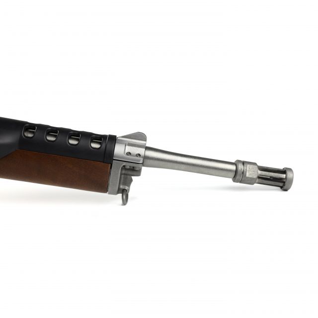

Jim at JP grips did the barrel work.  Cycles fine with the factory gas bushing but I am going to test it with a couple different sizes over the weekend.
Still need to fashion up a AC556k style front sight (without the Samason sling loop).
Probably throw a Aimpoint on it as well.
This gun makes me giggle every time i look at it.

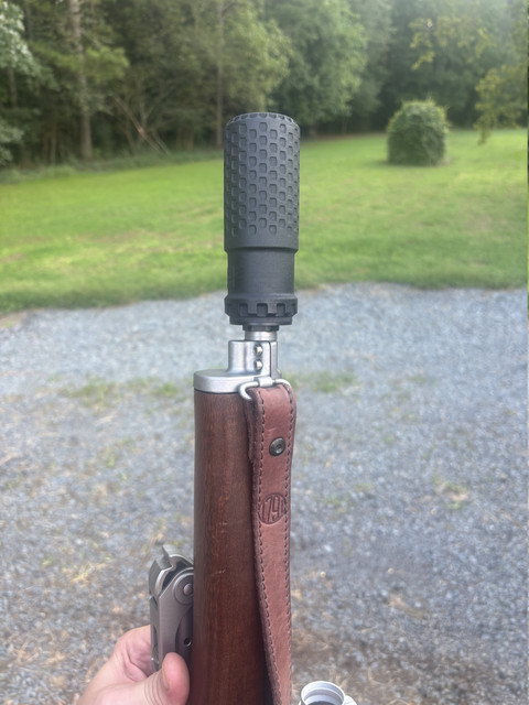

Update:  Finally got my Rhodie6-k today and it is now dedicated to the micro14.
First impressions: ZERO gas to the face compared to before.  Very cool.
No noticeable POI - just using ECCO Machine dt mount same as the previous suppressor.
Sounds great.  It’s a short 5.56 suppressor, have reasonable expectations.
Overall length is less than a 16” bbl (this is important to me, short as possible but still functional)
Even made a few hits on a 7x12 plate at 333yds with the old ultradot 2moa and 75gr Hornady frontier lol.
Such a fun gun to shoot!

thats classy as fuck

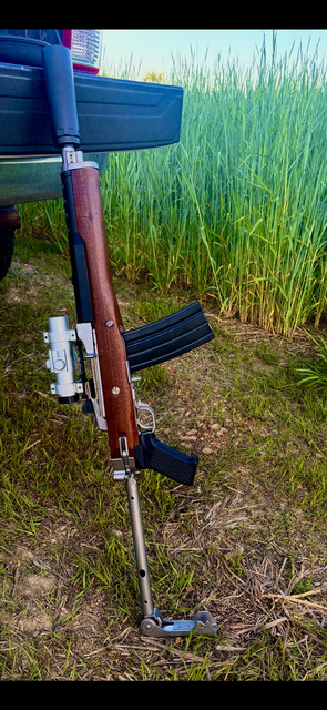

I am waiting on a Samson front sight gas block to come in then I will have to grind the stupid front sling mount they added to it off.  Until then i will probably just put an aimpoint on it.
Put 200rds through it yesterday evening, no malfunctions.  The Stacy’s Mom K sounds great on it.

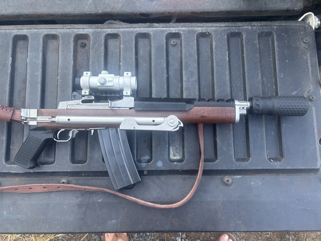

Not much to add, put another 300rds through it with no issues.  100% reliable so far.  Got the Ultradot zero'd - banging 7x12 steel plate is boringly easy at 100 yards.

https://i.ibb.co/7dmpD8M7/IMG-0755.jpg
That is so awesome. I need to do this to mine
