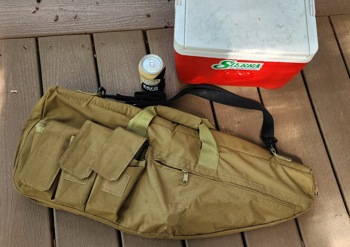

Do I trust my life to the RDB?   y..yesss, with the following
This is how tidy a Grab and go 17" 5.56 gun it is:
- Make sure you run 1000 rounds through it first, and run it HOT.  Handle it.  Bump it around.  Figure that gun out.  Run a spectrum of ammo.  From that you will learn the following critical items:

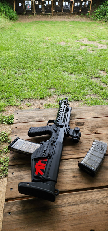

-Beware the grip point of one handed carry of the RDB, can inadvertently cause magazine release.  I consider this to be the most serious of all the design defects of the gun for serious field craft usage.  You will carry the gun there at some point, and you will eventually drop your mag from doing so.  (overfixation on silly irrelevant time savings on reloading a semi-auto civilian gun irks me - this is a terrible trade-off for game-boy 1/5th second time savings, for when rifle shots 1-30 apparently failed to do the job.  A more secure system means you get to reliably have shot #2-30!!)
(it just did that to me.  First time, but pissed me off)

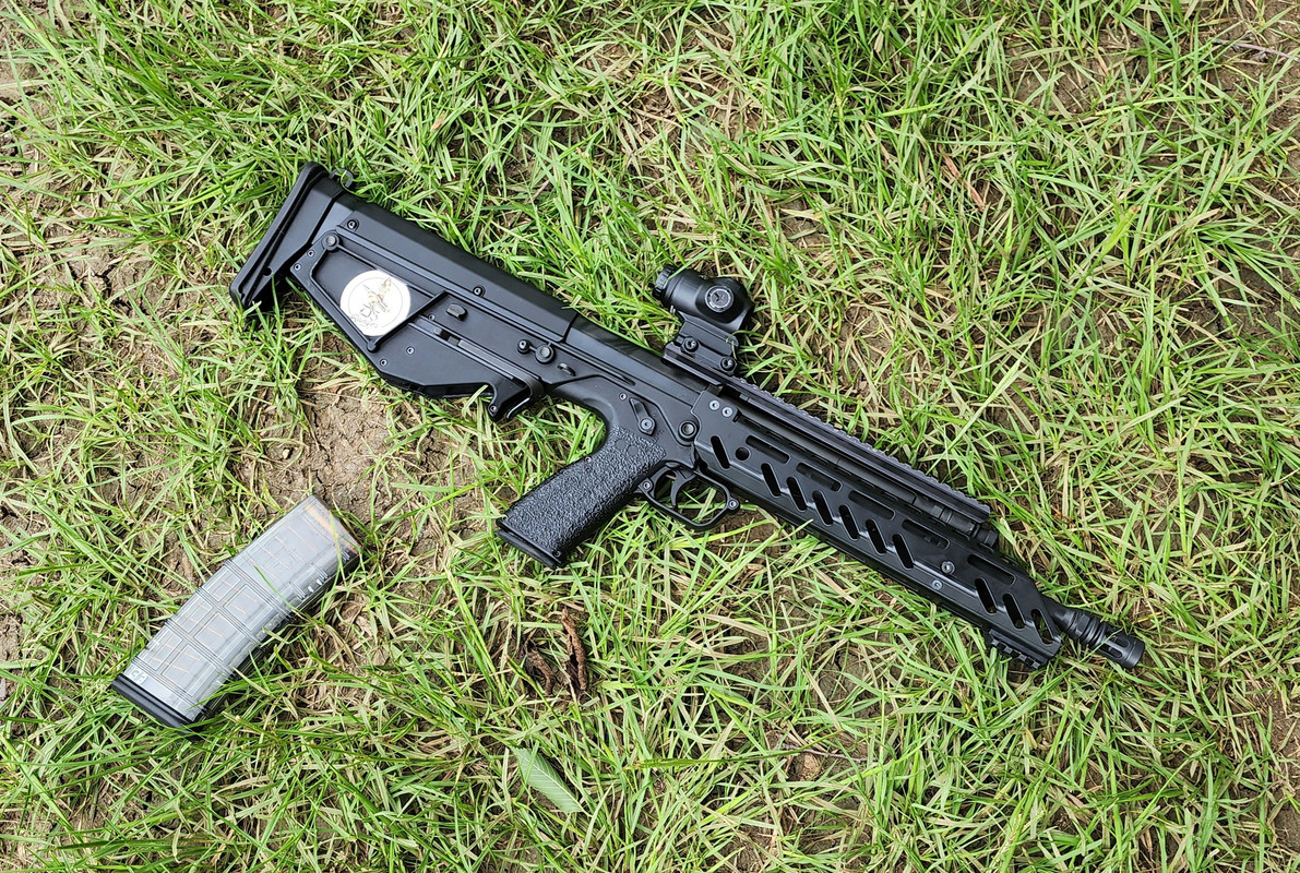

-Remove the back 2 (round metal) sling swivel points.  They are secured by a weak retaining ring that will fail when that point gets whacked.  which will drift the point into the gun and block hammer drop.  They arent needed, just pull them out, they are a design flaw for actual bang around field craft.
You can leave the related holes there open, it wont hurt anything, but I covered mine with an HK sticker
https://i.postimg.cc/fyY5vjDn/20250607_103053.jpg
https://i.postimg.cc/MK8QBJLF/20250518_133529.jpg
https://i.postimg.cc/m2NFN6f2/20250518_133026.jpg

What aftermarket forend is on that RDB?  Totally changes the look of the gun in a good way.

Thanks!  It's from Lucky Irishman.  They offer 2 designs, and I like the look of this one best.
