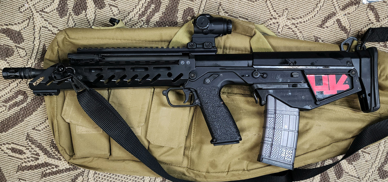

4/27/2024 update:  Fired 30 rounds
A friend wanted some help with her pistol training (which went really well) and this is where she discovered that she needs to shoot left-handed, if she's left eye-dominant; and things started getting better.  So she ran a rifle left-handed for the first time ever, and actually liked the RDB nicely, which caters well to that.
Also, updated the photos of my el-cheap0 $20 TEMU gun bag.  Which just looks too small to work, but it does, and comfortably.  Despite the photo, the zipper doesn't actually stretch any to fit; it's just the perfect length.
Total round count:  1167 rounds

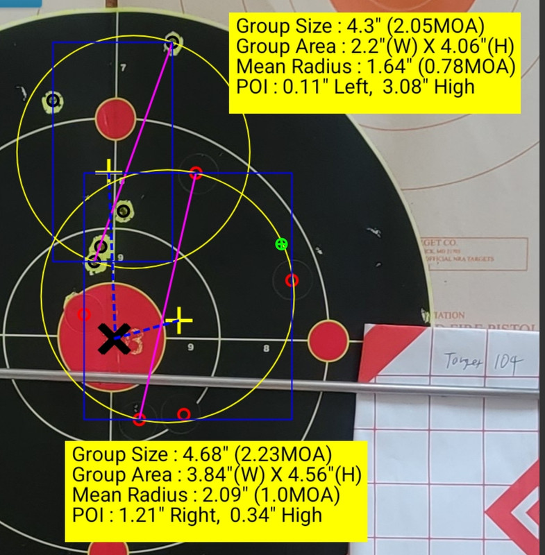

After the high heat trial, I altered my laser/light concept and decided to go with a different more resilient unit (the 450LM unit holds up better to recoil at keeping zero, than the bigger 600 LM unit), and I went with a different non-quick-release off-set rail, mounted further back - to try and stay a bit farther from the heat, and also hopefully not fall off, when it gets hot.
Of course there is some experimental error "noise" in there - such is the way of things.

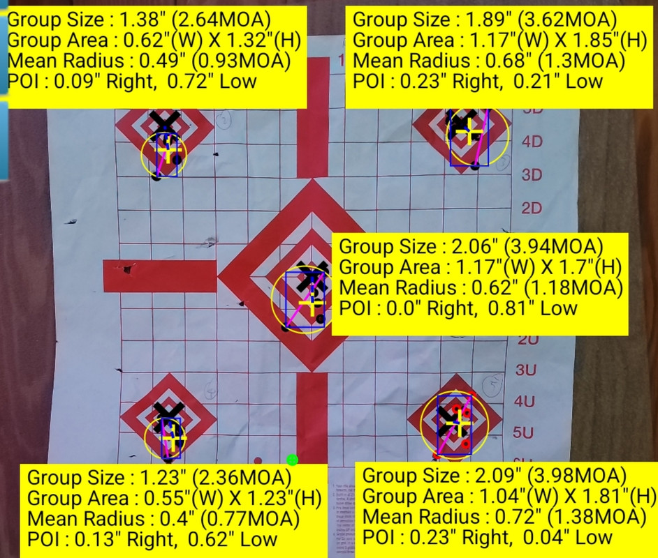

5/19/2024 update  Fired 50 rounds today (no jams or other issues)
Two goals today:
1) Zero the laser - and test how well it holds zero
2) do a 5 strings of 5 test, for MOA as well as POI observation
Accuracy wasn't that great, I ran some 55 ball, and the gun hasn't been cleaned for a quite a while now, so maybe a factor.
Sequence of fire was at just 50 yards, from bipod
1st string - CENTER
then
2nd - Top L
3rd - Top R
4th - Bottom L
5th - Bottom R
And tried to run quickly so the gun could heat up.
Results inconclusive since the groups were pretty large.
First cold group in dirty gun was biggest - at 3.9MOA, and 1.6 MOA low
Last group was : 3.98 MOA, 0.1 MOA low.
With smallest group at 2.4 MOA and 1.2 MOA low
I did try some better ammo, and got:
I think I can get that down to even lower.
Green laser held zero decently, but not great, and would shift around a couple inches at 50 yards.
Total Round Count: 1310

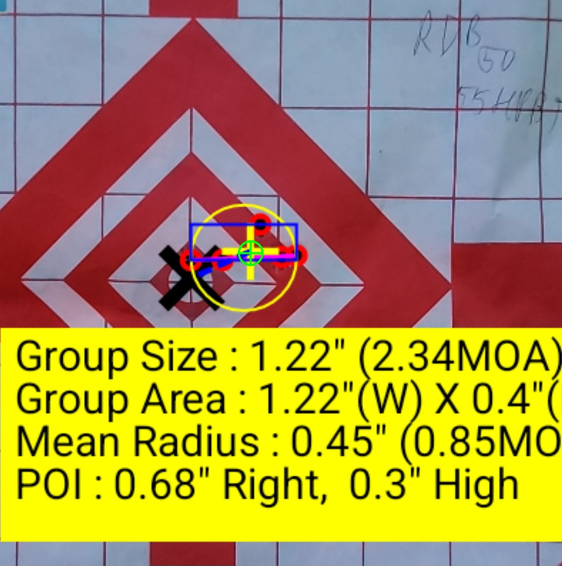

5/27/2024 update  40 rounds (no jams or other issues)
After discovering the loose handguard, was curious if last outings accuracy results were related to that.  It appears so.  After a good barrel cleaning and tightening the handguard back to the handguard, accuracy was better today.
POI moved a LOT, like 10 MOA, by tightening back down the handguard.  That really surprised me.
once done with that:
200 yards:
Top group is the OLD NORMA 55gr TAC, the stuff with the European brass.  Which is known-match-quality 55 FMJ ammo.  And it shot 2 MOA.  Which isn't super great, but for this gun, 2 MOA is about right, and not bad.  Gas was at -4, and 2986 FPS
Bottom group is my own mass produced 55 FMJ reloads (Hornady bullets) - 2.2 MOA.  Meh, I'd prefer 1.5, but I guess not going to get that.  I can make 2 MOA work.
100 yards:
shooting some 55 HPBT reload pulls.
Eh, serviceable.  First group fired cold was the center, and that was the biggest group.  As it warmed up, got below 2 MOA, so not bad.  POI didn't shift a whole lot, which is good.
Fun day shooting, it shot OK.

3/09/2025 update  50 rounds (Two no strikes - likely the ammo fault, not the gun)
Did some quick CQB shooting with some old 55gr reloads.  A portion of this older reloaded 5.56 ammo lot wasn't working in a separate AR due to insufficient ammo headspace (too long, not resized enough).  Two rounds from this same lot, run through the RDB, did not fire.  No primer strikes, so again, probably too long and the bolt wouldn't close - not the guns fault.  The really odd part though, was these rounds were very easy to extract and remove.  In an AR15 I would have to mortar and just PITA when headspace is too long.  But with the RDB, there was no effort at all racking the handle to jack the round out.  Just odd.
A fellow at the range came over curious what the gun was.  When he fired it:  "not only is the recoil low - there's no recoil at all with this gun!  I need to get one of these"
Total Round Count: 1650

You figured out a decent way to mount a light to the stock handguard without using the bottom rail? I was thinking of trying to mill some mlok slots into it using a template. And then also shaving the pic rail off the bottom.
Also, can't remember the user but he modified a Magpul Zhukov S handguard. Pretty awesome just don't like the gap between the trigger guard and bottom of the handguard. Had a black RDB and regretted selling it, now have an FDE one.

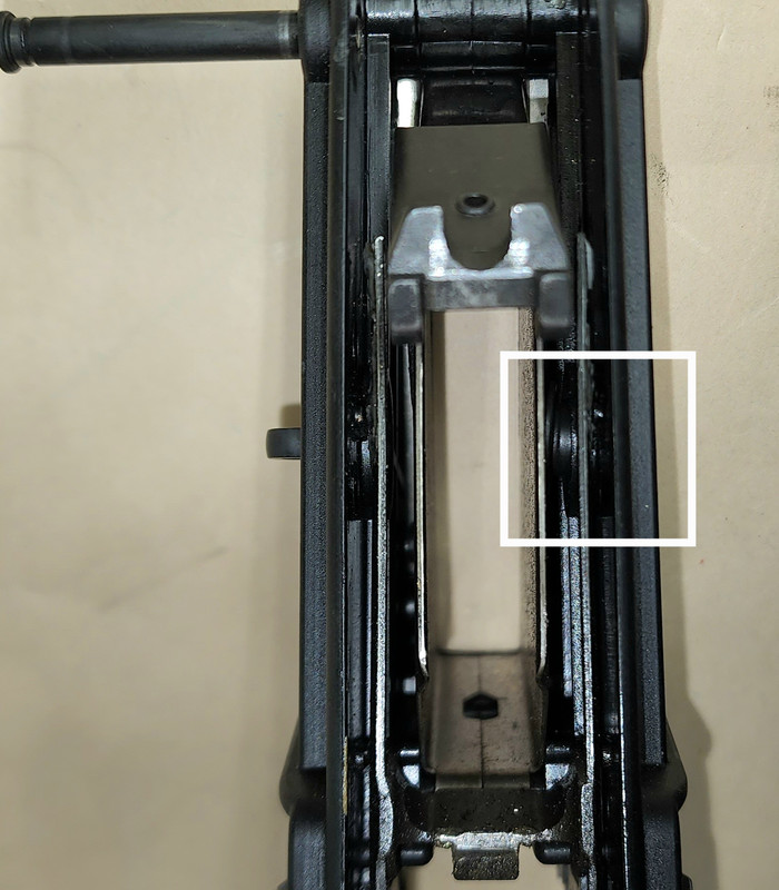

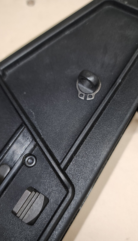

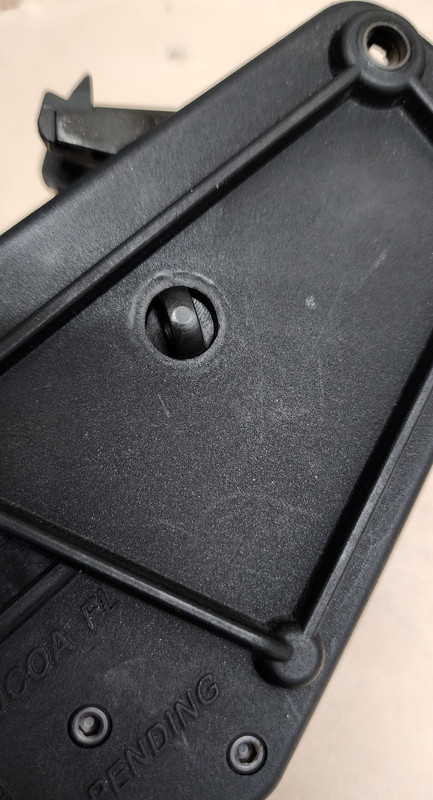

3/22/2025 update  200 rounds (No-fire hammer strikes - diagnosed to a gun part that broke - see text)
Did some 200 yard shooting to see heat effects on POI, and quantify some zero's.  Disrupted by frequent failures to fire, that I couldn't diagnose fully until got home.  Accuracy was only mostly OK, at 2-3MOA and zero seemed to hold OK, I think.  Need to repeat.
Here's what I saw when I finally had a chance to take a closer look at the gun, while trying to figure out why I was getting click - but no fire.  And the brass was coming out untouched.
So apparently the clip that holds the fairly stupid out of date sling mount hooks, fell off, allowing the sling-point to fall into the gun, which was blocking the hammer from going all the way home.
So, I pulled out the back 5 screws on each side (10 total), and was able to peel apart the clamshell well enough to just pull out those two points, to mitigate that risk of failure from coming back.  I never use those mount points anyway, and this is a weak design implementation.
Now I've got 2 big holes in my reciever though.  It's not a big deal having the holes there, it doesn't hurt anything.  But I looked for a sticker or something to cover them anyway.
Ah, here we go - found this sticker floating around:
Total Round Count: 1850
https://www.ar15.com/media/mediaFiles/90543/IMG_8540_jpeg-3498077.JPG
Not yet.  I tried doing one of those lightweight 45 degree offset rail mounts, but it couldn't take the abuse and fell off.  I like the concept- but sometimes $5 Amazon works fine.  Sometimes it does not.
I upgraded to a higher end quick release 35 degree offset to only reply the light manually at night,  and keep it off during the day - to keep the gun lean.  It's ok.
3/24/2025 2:54:02 AM EDT
so that's interesting - you removed your sling swivel too I see.  as well as your back screws.  Why did you remove the back 2 screws?

Shot it some this weekend with a friend.  Zero checked and some CQB running.
It's zero'd for 200 yards.  One nuance I've learned with this gun is if the handguard screws come lose, the zero gets really wonky.  I did a full start-over and just pulled it apart, and then did a luckyIrishmen spec torque, and blue loctite.  So far it's actually held (often the screws would walk out, even when above spec-torque).
Zero and groupings are OK.  Zero check at 200 yards.  It was basically 4" or so, and mostly in the black on a 12" circle.   Did some shooting and lighting up some steel.  Zero checked again, and maybe drifted a little bit, but about the same.
Good gun, but it has nuances.  For example, to get it soft you need to dail in the gas settings.  But if you switch ammo, you may need to adjust.   It never jams mechanically, but it can jam if undergassed.  Which isn't really the guns "fault", but it can happen.  When it does, the gun always clears well enough with magazine removal and bolt stroking, so it's not actually a huge deal.
Still quite like the gun.  It's time to do another 3-mag ammo dump, to give it another work out.  Maybe next time.  But I like it, it stays on target good.

6/07/2025 update  - 160 rounds over several outings.   Excellent mechanical reliability and function; accuracy is only so-so.
Fired it in several settings and distances with a spectrum of ammo.
For the CQB runs, fun gun for sure.
One item I've always been iffy on the gun, is the magazine release and its location.  It strikes me as something easily engaged inadvertantly.  Not so much when running the gun, but in the non-firing handling (what's the cool-crowd term for that.. Administrative Usage? or whatever).  The balance of the gun is excellent and when one-handed you will grab it right in the middle.
So sure enough, I set the gun on the ground, then when I went to pick it up in that center area one-handed, out came the magazine.  This irks me. It's only ever happened this one time, but I wish there was a way to minimize that potential further.
Anyway, that's the only mechanical aspect item.
As to accuracy, it's just variable with this gun.  Some groups at times can look this good.
That's a pretty darned good 200 yard group.  But not really typically, mostly of the time in a 5 shot string, there will be one wild flyer (as seen here in fact).  Almost every time.  It just throws a round at times, I don't know why.  And typical groups are close to 2-3 MOA.
But that's one detail that just odd.  At 25 yards, this gun can give me a 0.25" group - that tight.  A solid 1 MOA.  But at 100 yards, it'll be out to 2 or 3 MOA.  And at 200 yards, same or worse.  It's odd.
In one outing I had gongs at 500 yards, and frankly, couldn't get this gun to connect very well at all, at that distance.  Frustrating, because this is an increadibly tidy and compact grab and go gun.  Literally, it's this small of a grab and go kit.  That's a 17"BBL 5.56 rifle, 2 30's and a tool pouch, quick attach bipod, and even the sling (as the shoulder strap of the bag), all in that tiny grab and go bag.  That's remarkable.
I just wish I could rely on it to hit a 10" gong first shot at 500 yards.   Maybe I'm asking too much.  I'm probably asking too much.  Frustrated, because my AR15's can do that.  Pretty much all day; 1st shot every time.
I'll keep at it though, I just love everything else about this gun, the form factor, the compactness, the weight, the trigger, the handling, the reliability, the soft recoil - it's a great little gun.
Total Round Count: 2140

It worked!
My scheme to mitigate the dreaded RDB stuck-bolt-lock issue some folks have, totally worked.  I ran close to 20-30 magazines to bolt-lock today, and none of them had any problems after my simple JB weld trick.  Gun ran smooth and easy with the factory bolt-release button all day long.  Whereas before this, about 80% of my mag-locks were locking up the gun requiring a high-vigor manual cocking action.
Here is Lazy's guide to eliminating RDB stuck bolt issues.
Short answer: A spot of JB Weld on the outside of the bolt-lock tines, to prevent them from being thin enough to fit and wedge in the gap between the bolt-carrier and upper receiver; but light enough application to not affect mass and free-motion of the bolt-stop mechanism.
Long answer:
Problem statement: For those experiencing the operations hang-up of the bolt-getting stuck in the lock back, to the point where the release lever isn't usable, and it takes a high vigor manual cocking action to break free.
Cause:: This is caused by tolerance/play between the receiver rail and the bolt-carrier, allowing the tine at the end of the bolt-lock to get wedged between the reciever and the bolt carrier, locking the gun up; after the last round of a magazine.
Corrective action procedure:
Step 1: Identify which side this is happening on.  This will be evident by scratches forming on the inside of the receiver rail, where the bolt-stop tine (the end of the 4" long bolt stop part, where it engages the face of the carrier to stop the bolt).  In my case it was on the right (starboard) side.
Step 2: apply protective tape on the inside of the lower receiver so that drips and overages don't get stuck on the ejection chute outside wall or on the plastic lower.  (I used electrical tape applied to the inside surfaces flanking the bolt-stop tine; for both tines.  (where "tine" is the end of the long stamped-metal bolt-stop that engages the face of the carrier)  I.e. Tine is clear, but the receiver components around it are now covered in electrical tape for the duration of the application procedure.
Step 3: JBWeld and toothpicks.  Carefully apply a small 1/2" run (ish) on the outside of the metal tine, towards the end.  This can be quite thin, 1/32" layer.  The purpose of this is to every so little, push the tine in, so it no longer is aligned with the tolerance-play gap formed between the bolt-carrier and the receiver rail.  So that now it just engages the face of the bolt-carrier.    Note this application is only effective where the tine part gets raised above the lower-receiver and into the channel-area of the upper.  So only 1/16" down the tine is needed - if that.  Don't apply to the contact-face of the tine that engages the face of the bolt-carrier, as that part will get impacted and I can't say if it will hold up long to that.
Step 4: Using clean toothpicks, scrape the face and top of the tine clear, and then with a clean toothpick, run it along the top of the tine at a 45 (or so) degree angle, which will put small angle on the JB weld that's applied along the vertical outside surface of the tine.   Do this for both tines.  This way as the bolt-stop tine gets raised by the empty mag engagement and contacts the upper receiver rail, it won't just stop, but push in a bit, which is all you need.  We're talking 1/64" is all it takes to eliminate this problem.
Step 5: let sit for at least 8 hours, then pull off the tape, reassemble, and make sure everything is running OK by hand action (i.e. make sure you don't screw up and JB weld something frozen somewhere)
Lazy, have you ever considered making a YouTube video that covers this procedure? I think it would help clarify how you corrected this.
