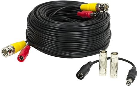

How do those cameras get power?
9/27/2015 6:11:42 PM EDT
The cameras with that kit are wired cameras. They use a Siamese BNC video and power cable. The kit includes a power adapter to power the four cameras.
