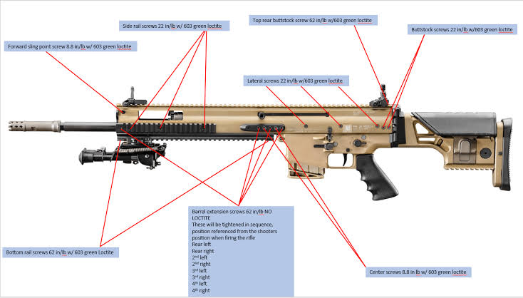

Watching this 9-hole review video Henry mentioned that there were specific torque specs for the MK20 that mil units figured out through trial and error to squeeze out the most accuracy. Does anyone have these or other recommended torque specs and procedure that they could share for either the Scar 17 or Scar 20? Thank you. https://youtu.be/GWT_QakNzUM?si=WrQfJYy3duIXQlWh |
Originally Posted By Mblades: https://encrypted-tbn0.gstatic.com/images?q=tbn:ANd9GcR5NOl8_zM4bWgqym-xP2r7y_wgZMZkDI9-c03ta3mUsjCXmwbF-4SfIt4&s=10 Get one of these to make it easy. https://encrypted-tbn0.gstatic.com/images?q=tbn:ANd9GcSbeVCjiULWmxlcGJ3b6BcrRQbMwDT2ov760qM-zfaVKg&s=10 Thank you very much! Is there no secret sauce I guess for torquing to improve accuracy? I’d assumed there might be something more to it that would help |
Originally Posted By henryfrank: Thank you very much! Is there no secret sauce I guess for torquing to improve accuracy? I’d assumed there might be something more to it that would help Originally Posted By henryfrank: Originally Posted By Mblades: https://encrypted-tbn0.gstatic.com/images?q=tbn:ANd9GcR5NOl8_zM4bWgqym-xP2r7y_wgZMZkDI9-c03ta3mUsjCXmwbF-4SfIt4&s=10 Get one of these to make it easy. https://encrypted-tbn0.gstatic.com/images?q=tbn:ANd9GcSbeVCjiULWmxlcGJ3b6BcrRQbMwDT2ov760qM-zfaVKg&s=10 Thank you very much! Is there no secret sauce I guess for torquing to improve accuracy? I’d assumed there might be something more to it that would help Not that I know of, I’ll have to go watch the video. If I had to guess it would be that consistency is key. I wish I would have checked my 20 when it was new but I did check my 17 when I first got it and 1 screw was over tight, the other 3 were varying degrees of too loose one took about 2 full turns. It would be easy enough to try different torque values and shoot a bunch of groups to see if it makes a difference. I follow the guidelines I listed and my 20 hammers. I swap between the 6.5 and 7.62 barrel regularly, it returns to zero and the groups the same. |
