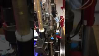

Got it back running today. Unfortunately, I am having an odd issue with the Bullet sensor install. It appears to work fine. But there is a mirror that is mounted to primer tube. It reflects the laser back to the sensor. The mirror holder rubs against the die plate as it goes up/down. I am only slightly concerned. I emailed Mark 7 asking what they think. They asked for pics. Will see what they say tomorrow after reviewing pics. Wondering if my Primer system is slightly bent after years of use? I am not noticing anything. As I said, the system does work. With time, the mirror holder will wear enough to not matter. I just don't like the friction or debris from the rubbing. I will probably polish it up a little and try again this weekend. As for the system itself, it is great most of the time. It detected missing bullets MOST of the time. The only problem I had was if there was an upside down bullet in the feeder. The result is typically two bullets dropping. When that happens, most of the time the top bullet falls off quickly. Sometimes it makes it to the seating station (where sensor is) then the top bullet falls off. That split second of a double stack in the seating station is enough to send a signal to the sensor (speed of light!) saying there is a bullet on case. The press continues. Root cause is not really related to the bullet sensor. Root cause is problematic bullets. I bought some RMR pulled 357 sig bullets. They are kind of junk. They are HP bullets and the HP varies greatly. Resulting in issues with flipped bullets on occasion. I have not worked out a flawless setup yet with MBF. I can see that the bullet sensor itself is worth it for most applications. Maybe not so much for this one. |

Ran about 2500 rounds of 223 last weekend. I went ahead and used the last twisted pair of wire to hook up to the dillon powder check die. It now shuts press off when powder level in case is out of the range.
Quick review of the laser bullet sensor from Mark 7... works better on wide bullets than 22 cal. The reason is simple.. When the case/bullet is in seating station position, bullet must block beam in order to continue. If there is any case wobble, the beam has a chance of briefly passing and being detected. I wonder if there is less wobble in the Fast and Furious 223 shellplate? Of course running press slower would help too.. but that's no fun: ![]() Mark 7 Dillon 1050 running .223 |
