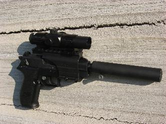

Sig Mosquito (tactical model):  will not cycle Aguilla subsonics but will cycle remington subsonics.  THe bulk Federal hi-vel works pretty well, and of course all of the other hi-vel ammo works great.  My favorite is the remington subsonic because it is quiet and cycles.  My second favorit is the Federal bulk hi-vel.  It apparently is very lightly loaded and is not much different than subsonics out of a pistol.

The Sig:
