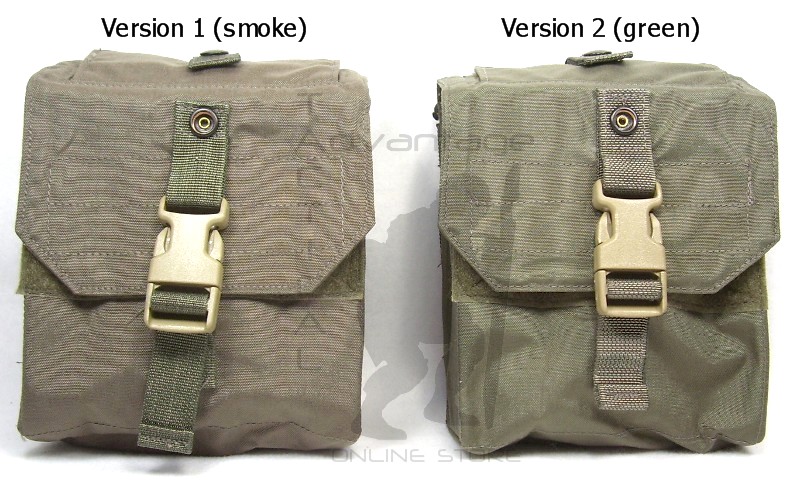

Interesting observation from the ruck sack laboratory. It seems as though this Rit Dye turned the buckles brown as well, they always stayed grey before when i dyed stuff. Attached File Attached File |
Originally Posted By WillieTangoFox: Interesting observation from the ruck sack laboratory. It seems as though this Rit Dye turned the buckles brown as well, they always stayed grey before when i dyed stuff. https://www.ar15.com/media/mediaFiles/123862/IMG_0641_jpeg-3546447.JPG https://www.ar15.com/media/mediaFiles/123862/IMG_0640_jpeg-3546448.JPG Yea, I've been quite happy with how I've been dialing in my dyeing of ACU stuff. It's almost at the point of being pretty dang good. |
