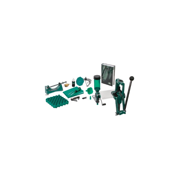

http://www.midwayusa.com/product/937051/rcbs-rock-chucker-supreme-master-single-stage-press-kit
I suggest this kit and add a trimmer, tumbler, and caliper.
That other kit had stuff you don't need to start this hobby.

Sir, I second your recommendation.  However somewhere in there I assume there's a scale.  He'll need that as well.  7zero1 out.
ETA, on second glance is that an RCBS scale on the shelf just to the left of the Dillon PM and above the spare primer tubes?

I'd go with the kit GWhis pictured.  It's better to start off slow and simple. The kit you mentioned has a lot of stuff that I've loaded tens of thousands of rounds without using.
A good single stage press is something you should have. Even if you do most of your reloading on a progressive, it's nice to have a single stage for small batches, to swage primer pockets, to pull bullets etc.
The rockchucker is a great press. You could beat an elephant to death with it, hose it off and use it again.

Yes that's my scale.
With that pic I was trying to show that I use my Rockchucker even though I have a 550.
So the kit I linked would be a good start. IMHO
