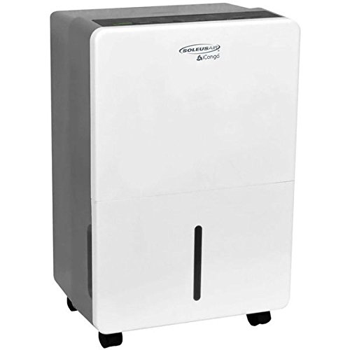

Hi well I had to give my inside gun room up  .. . .  very sad. everything has to go in the garage in a sub-room. This room has a lot of humidity and when it rains  . . . don't get me started. In the past, i  dropped in my safe rechargeable desiccant eva dry (X 3) in the same location wasn't enough to beat the rust and I had to turn to Eezox.  I'd like to prevent this and stay way from the Eezox. Other than a 55-gallon drum of desiccant. Would 2200  sqf professional Dehumidifier that drains into bucket work? My safe is a huge TRTL-60 government safe I won at auction that doesn't have any access other than a coin drop so I can't get a golden rod in .
Amazon Product
  • Control: Electronic
  • Gallon Capacity: 1 Gallon
  • Humidifier Temperature: Hot/Cold
2/19/2017 4:22:36 AM EDT
I would run the drain hose outside. in a humid room it doesnt take long to make a couple gallons of water and
be ready because they put out a good bit of heat or mine did anyway. you say 2200sf but really how big is the room?

I had that exact one in my gunroom in my shop for 5 years. Piped the drain hose to a drain. Ran it on 50% for 5 years. No rust, no problems. I live in Seattle, so it gets a little wet here. You should be good to go.

To the OP - I run a dehumidifier in my gun vault 24/7/365 and have absolutely no rust issues.  I only wipe down used firearms with an oily rag and store; no spray and wipe.  It can get pretty humid here but I have never had problems with rust.  I also run a separate dehumidifier in the basement so may be overkilling this a bit.  Better safe than sorry, I figure.

Unless your in your gun room everyday, plan on plumbing that to a drain. It doesn't have to be perfect, even just a garden hose, but with a gallon holding capacity, depending on how humid it is it can do that in a hour.

I'd also run it to a drain.
Put some rechargeable dessicants inside the safe.
Get some Vapor Phase inhibitors also VPI/VCI
