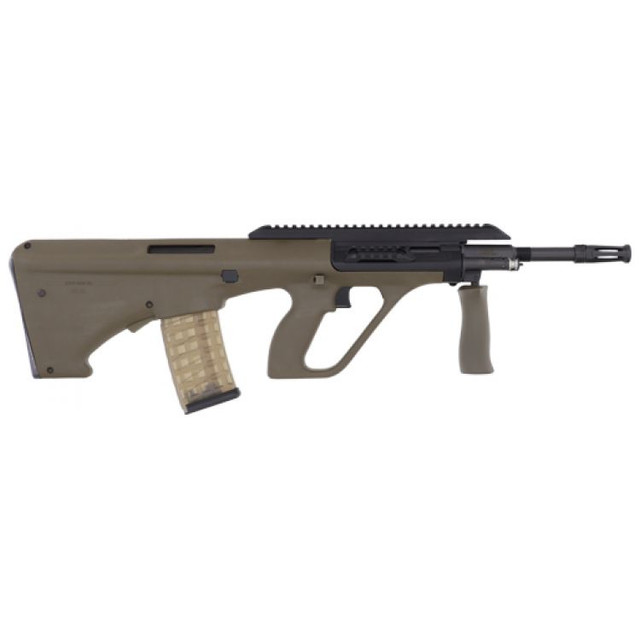

Five decades of shooting has taught me a few things.  One of the important lessons is ... the best AUG spare parts kit looks like this ...
11/26/2025 7:45:41 PM EDT
[Last Edit: kiddsf][Edited] [#29]
https://i.ibb.co/21BdTjdy/GAUGM2-GRNEXT.jpg
With respect, I disagree and discourage others to do this.
Minor parts like springs and pins as posted above seems to break around 6k-10k rounds. It doesn’t make sense to shoot 20k rounds only to have 2-3 spare complete INOPERABLE rifles with gutted parts. Per your method, and since some parts do break earlier than other parts, I’d be going through 2-3 (or more) complete guns just to get their $100-150 minor parts and with those 3-4 guns as “spare parts” I’ll likely never use.
Side note, they are seeing similar situation in Switzerland where the Army is now gutting complete guns bc they are now out of spare parts. They now have a lot of “gutted complete guns” with missing common wear/breaking parts. That’s a lot of wasted money.
It doesn’t make sense to buy a new or used complete car just to gut out the brake pads, tires, and rotors.
Complete rifle doesn’t make financial sense as a “spare parts bin”. But it does make sense as a backup firearm.

Repair Kit $235
Bolt $330
Barrel $495
Trigger Pack $135
Stock $360
Stock Pin $25
Buttplate $45
$1625
Whole gun …. $1600 … they pay you $25 to take a free RECEIVER.

And how many parts from that do we actually need to service a broken rifle w/ common wear items?
Also like cars, complete car is valued less than sum of its parts if you part them out.
But again as mentioned, no one is buying complete cars just to get the tires, brake pads, rotors (unless absolutely no choice).
Obviously I can't convince you on this but maybe others can at least consider my opinions on this.
It is just wasteful to buy complete rifles to treat it as spare parts bin when many of its parts won't be what you need.
Buy complete rifles as immediate backup. Don't treat them as items you gut out from to service another rifle.
