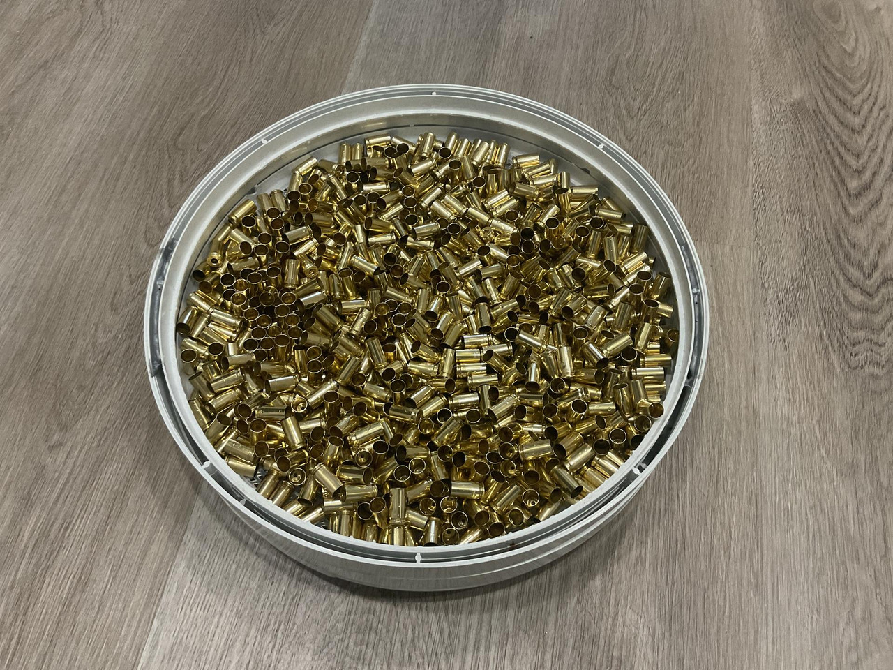

The batch I pictured on the first page of this thread ran for 2 hours.
I was getting hungry, so I ran out to Subway, for that last hour.
So when I got back, I was really impressed by the bling.

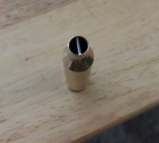

If I use wet tumbling with pins again, it will likely only be on straight-walled cases.  That worked.
When I last tried, I could never get all the pins out of my bottlenecked cases.  The failure rate (trapped pins) was unacceptably high.  Even using the media separator, I had to inspect and tap every single case to ensure I got ALL the pins out.  I was surprised how many pins came out with tapping.
Then, there was one instance where a pin got wedged across the opening of the case mouth (see photo below).  That is just not okay by me.  The thread with those stats and pics has slipped into the archives.
I was using the 45 cases as a surrogate for a batch of bottle-necked rifle cartridges sitting on my bench.  Many said you do not need pins to get them clean, so the 45's were a test of that.  The test was a failure.
https://i.ibb.co/NgFjSGm3/Stuck-Cleaning-Pin.jpg
I tend to shake the pins out of bottleneck cases and then rinse and shake them out again.  I do this while holding 30-50 casings in my hand.  Yeah it takes longer than straight wall brass, so be it.  Not a big deal.  If you use a brass separator the casings will orient themselves mouth up and makes it easier for you to grab a bunch at once.  .223 are the most problematic, larger diameter bottle neck cases tend to let the pins out easier.
Could one magnetize the decapping rod assembly enough that any pins stuck inside a bottle necked rifle case would get pulled out?
or if you have an extra decapping rod assembly could you epoxy one of those neodymium magnets to it?
No pins remaining if you use the 2 bucket method I explained in a previous post.
Pins wedged in neck.
That's easy, they are out of spec, remove them and throw in trash.
In the 15 pounds of pins I use in 3 tumblers, I've had that happen about 5 times.
Haven't had that happen in years.
You are going to get out of spec pins.
Condemn the who batch because of a couple pins?
Not in my world.

I de-primed some .45ACP’s the other night.
Put them in the FART, set the timer for two hours.  Then I went out to eat dinner.
When I came back, it was still running.
I did some other odds and ends.  When I heard it shut off, I rinsed them, spun them in the media separator, rinsed them again, laid them out on a towel, and lastly, put a box fan blowing across them.
NOPE!  No issues with the mouths getting peened.
And the brass looked bling bling brand new.
