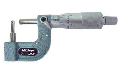

BTW - to directly measure case neck thickness you need a tubing micrometer. Using a standard micrometer will not work at all, and using a standard 6" caliper will not give accurate readings for this kind of measurement - its not the right tool.
Tubing Micrometer:
LINK
