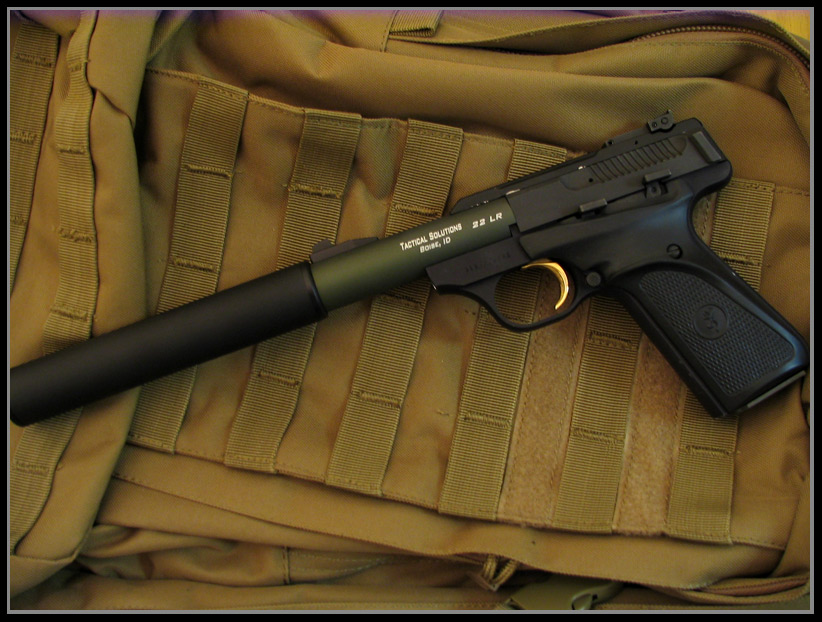

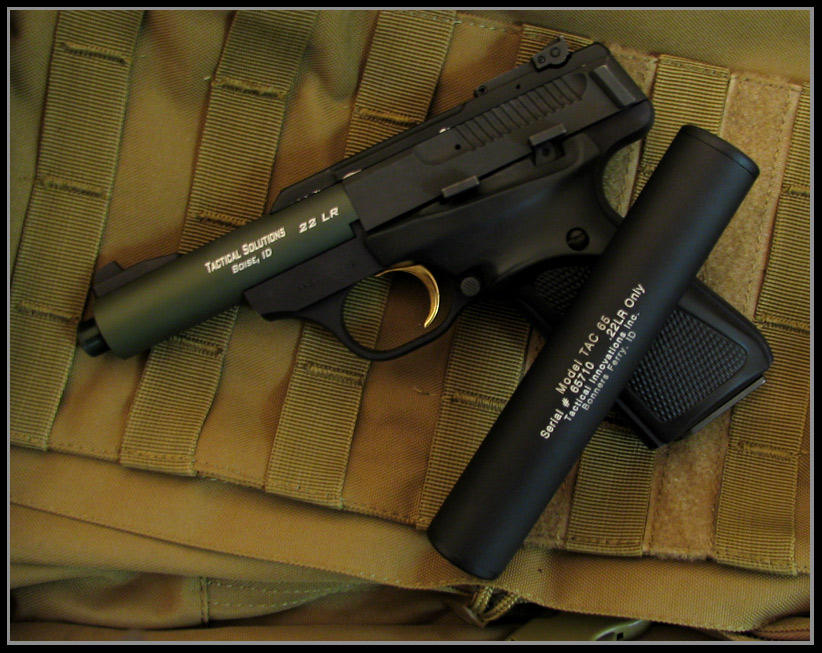

I *really* like my threaded 4" TacSol barrel.  Very light weight which makes for a great carry gun.  You'll need to buy a new rail to go with it - the TacSol barrels use the OEM rail, and I don't think your full-length rail will swap over that well.

I like my TacSol barrel.  Makes the pistol balance better with the TAC65 on.
