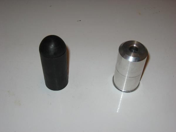

These are actually all 37mm but the concept is the same and other than being slightly smaller OD, 40mm are the same.
I have 26.5mm, 12ga, 16ga, and .410 adapters and yes, they are all aluminum.   They were made by machinist friends of mine.
THe black thing  is a molded projo a buddy of mine made, not an adapter.  It just happened to be in the same pic.

Hot off the lathe, made for 20GA, the length concerns me however, those with adapters, do you think this is long enough to safely shoot shot out of?, i have quite a few of these "birdbomb" type flares, they make a loud bang and yellow smoke, its some fine powder incased in a lot of lead so with a 20GA i can get a lot fo distance out of them. i'm still not sure if this thing is long enough to keep a round stable in the barrel. i don't have my 203 complete yet.
2/16/2008 7:49:02 PM EDT
Mine is probably a little shorter than that and I have yet to have issues with anything from bird shot to slugs.
