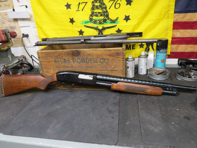

i redid my old 870 in 20 ga yesterday that i purchased back i 1993 , that old girl had seen a lot iof use over the years , the finish was all gone in spots and i kept finding rust because of it so in order to stop the rust cycle i stripped the metal parts , still have to do the trigger guard ,its metal coming from that time period , the lumber i did the same time i did this 500A furniture ,its nice seeing the old girl looking good again i have a Uncle Miles 1903 style sling for the 500A , i just put conditioner on it , i will let that absorb in and hit it again , will drill the stock stud and and get that installed , just have to dig one out of the parts drawers |
