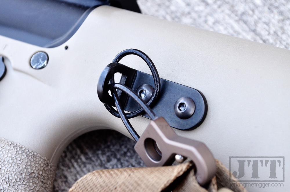

I would like to add a sling attachment near the receiver end of the buffer tube.  It looks like echo93 used to offer a service where he milled a slot there as shown in this picture:
If I drill a hole in this area to run a loop of 550 cord through, will the stock be hollow or solid?
Looking from the butt end there is a floor to the inner compartment, and the stock does not appear to be hollow where the rear sling slot is moulded.  I am wondering if the plastic is solid between the "floor" of the inner compartment and the outside or hollow.

@sinistralrifleman or backbencher or anyone else who ends up with a broken $5 lower beyond repair:
https://sinistralrifleman.files.wordpress.com/2013/01/cav-15-18.jpg
Sinistral will know better than I, but I'll bet it's a honeycomb.  So you may drill through mostly air, or you might hit a plastic rib that goes all the way through.  If you look @ the pics of my pistol lower, you can see some of the reinforcement they used.  I don't know how they did it in the web of the extended buffer tube boss, but I expect the same construction there.

I ordered one of these with plans to drill and bolt it with a metal backing plate inside:
https://www.amazon.com/gp/aw/d/B075X49KRW
Hopefully it will end up like this:
It just occurred to me that if the area was solid I could simply drill a hole and run some paracord through which would be simpler and cheaper.
I had also thought about using one of these:
https://www.amazon.com/gp/aw/d/B002E6NDX4/ref=mp_s_a_1_1?ie=UTF8&qid=1511323097&sr=8-1&pi=AC_SX236_SY340_QL65&keywords=harris+%232+hollow
But I am not sure it would have enough support.

Quoted:  I ordered one of these with plans to drill and bolt it with a metal backing plate inside:
http://jerkingthetrigger.com/wp-content/uploads/2013/03/E93-CAV-15-Modifications-Sling-Mount.jpg
