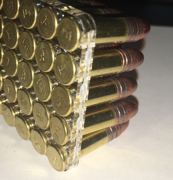

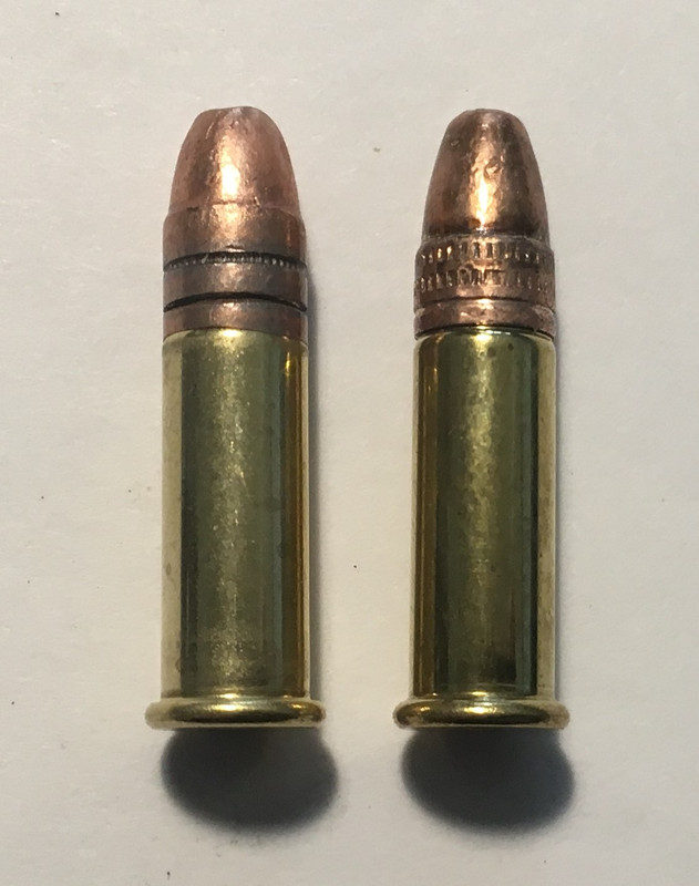

While it IS 36gr HP 22LR, it is NOT the same ammo as the Federal 550 bulk walmart ammo, or 525 "Champion" branded stuff we are used to.
Note the pics:
Black Pack on the left, Federal Bulk on the right:
The packaging plastic holders are IDENTICAL to the bulk packed CCI mini-mags, from the "Just Choot em" flavor.... they are snapped in half and have the rough edge showing they were once part of the 100-length size:
Now, let's compare to the CCI Mini-mags of the same 36gr varietal:
CCI Mini-mag on the Left, Black Pack center, and Federal Bulk on the right:
CCI is owned by Vista, same company thats owns Federal.  We have seen other offerings under the Federal brand that were actually produced by CCI, such as the aluminum cased 9mm that Federal sells to Walmart, which was made by CCI for years under the Blazer branding.
CCI 36gr Mini-mag specs are 1260 fps:   https://www.cci-ammunition.com/products/detail.aspx?use=1&loadNo=0031
Federal Black Pack specs for the 788BF are 1260 fps.
So, I cannot say for sure these are actually CCI Mini-Mags, but these are damned sure CCI Mini-mag bullets, loaded to the same 1260 FPS velocity according to the manufacturer as CCI Mini-mags, and NOT the same projectile that comes with Federal bulk.  It could be a combination of CCI projectiles, with Federal cases/priming, or it could be 100% CCI manufactured.... if the latter, that is a HUGE plus, IMHO.
