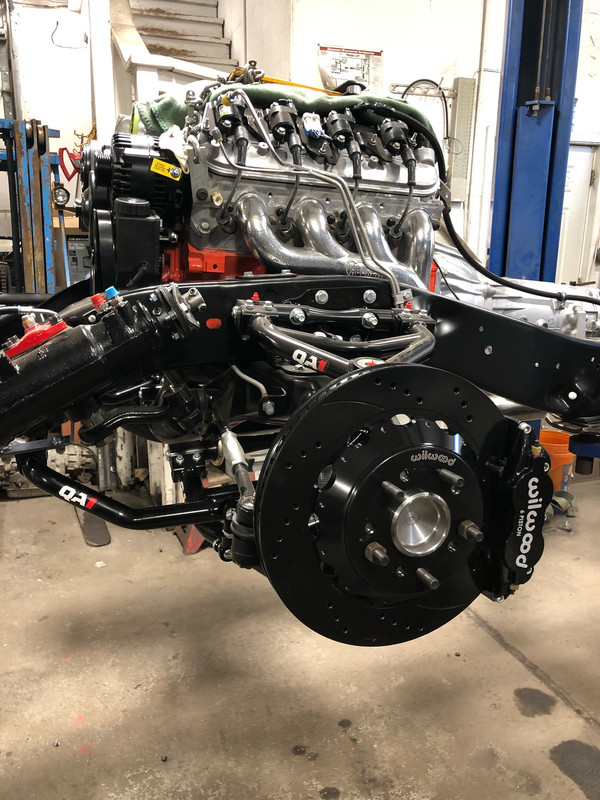

just a couple of pictures of my 2 Wheel Dr. blazer for a little inspiration. Following your build you're doing a great job.
6/16/2024 6:51:34 PM EDT
https://i.postimg.cc/cHvLrNSN/Front_Wilwood.jpg
https://i.postimg.cc/QttqyZkJ/floor.jpg
Damn, man! Looks great! That will be a sweet rig!
