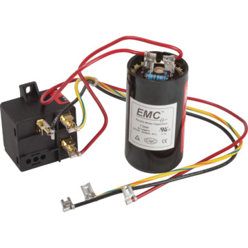

Now I do my own work. That is a ridiculous price to pay, and I feel stupid for having paid it. Good job getting yours done! eta: May I recommend you consider adding this is well. 5-2-1 Compressor saver. https://www.amazon.com/dp/B003FNL0EY
Reduced my start up amperage dramatically, and starts much smoother now. |
