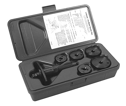

Does the Harbor Freight kit suck?  (5 stars, 30 Reviews)
http://www.harborfreight.com/disc-brake-pad-and-caliper-service-tool-kit-18-pc-69053-8546.html
Also--can you recommend a reasonably-priced bleeder kit (or should I just make one out of a soda bottle)?
Thanks for any input.

It doesn't look like many of you have changed rear discs on cars built in the past 20 years.

That kit mainly for brakes that have to be turned in, not pressed in. There are a number of vehicles that have brakes on the rear end that have to be tuned in and not pressed in. In fact pressing them in will destroy the whole calipers..... Best to know which one you are working on. But for pressed in ones....not necessary.

1997 Ford Mustangs have turned in rear calipers, as to Volvos and others. For those of US who do not buy new or foreign cars and are mainly allergic to Fords...we rarely encounter that.

Many rear calipers take a special tool, a c-clamp will not work.  The piston must be rotated back into position.  This tool I generally just rent for free at the auto parts places if I am working on a car that requires it.  I have a little one I got at auto-zone that is 4-sided and connects to a ratchet, and I try that one first, if it works then no rental needed.
I use a c-clamp for any pistons that are straight push back.

A C-clamp and the old pad will work on the front calipers of majority of the vehicles on the road, it's cheap and it works.
That being said, it's the rear calipers that throw a wrinkle in it. Due to the parking brake design on some vehicles, the piston has to be rotated back into the caliper in order to put new pads on. You can readily identify which vehicles require this by looking at the piston itself. Typically those pistons will be solid across the face with notches or grooves machined in to them. The kit the OP linked will work just fine on that style of caliper, however unless all of the OP's vehicles are like that, then I would likely just rent a similar kit from the local parts store.

Depending on how your parking brake works, you can either just press the rear caliper straight in, or you need a special tool. (I would go to autozone and rent one, if its a one time only use).
http://www.amazon.com/Lisle-25000-Rear-Brake-Caliper/dp/B0002SQUJU
For you heathens still using C-clamps, there are much better alternatives (that are worth the money if you do this professionally )
http://www.amazon.com/Lisle-24300-Speedy-Brake-Spreader/dp/B0009OR8V6
http://www.amazon.com/Lisle-25750-Piston-Caliper-Compressor/dp/B0002SQUTU

For twist in calipers I have a Lisle tool that I have owned forever as well
5/11/2015 10:29:44 AM EDT
If piston needs to be turned while pushing in, a large screwdriver used sideways like a pry bar will work.
Also check out a place like Auto Zone they loan a lot of special tools for no charge. You pay when you pick it up but they refund it (100%) when you return the tool.

OP, I have the same kit for pistons that need to be spun back in.  Mine came in a red case and cost $15 though.  That was quite a few years ago too.  No complaints, works great.  If they don't need to rotate, I still use the C-clamp, much faster thread.

I use a cheap little tool made by  Lisle.   It pushes out against a flat piece of metal shaped like fe a brake pad.   It's easier to use than a c-clamp.  Most auto stores have them in their tool section.

I have that kit and it works great.
Note that the big screw things are labeled LH and RH for left hand or right hand twist. Confused the F out of me at first, since I just reached into the case and grabbed the first one that came to hand.
Here's a cheaper kit on Amazon:
http://www.amazon.com/dp/B00GAC768Q?psc=1
Why do you need a caliper service kit? You can usually get by with a large C clamp (like this one from Harbor Freight for $6) to push in the caliper piston. Use the old brake pad on the face of the piston then the C clamp to push down on the pad. Use a coat hanger or bungy cord to hang the caliper from the springs so you don't damage the brake lines while replacing the pads and rotors. Don't bother with getting the rotors turned as its usually cheaper to buy brand new rotors when replacing the pads. Also prior to pushing in the caliper piston make sure to remove some fluid from the brake fluid reservoir otherwise your liable to have fluid erupt out of the reservoir when pushing in the caliper piston. Clean up any spilt brake fluid ASAP as it may damage the car's paint.
For bleeding the brakes don't bother with the DIY soda bottle things. I tried that and it ended up being a real mess because the plastic of the bottle reacted to the DOT 3 brake fluid became brittle and cracked, leading old fluid all over the place. Spend the money for a Mityvac kit from Harbor Freight or the like. Makes bleeding the brakes much easier if doing it alone.  You missed the 25% off coupon from Harbor Freight that was good for yesterday only. To prevent air from entering the caliper bleed nipple screw when bleeding the brakes you can either pull the bleed screw and put some thread tape on it, or use brake grease or petroleum jelly on the outside of the nipple where it meets the caliper housing to prevent air infiltration.
