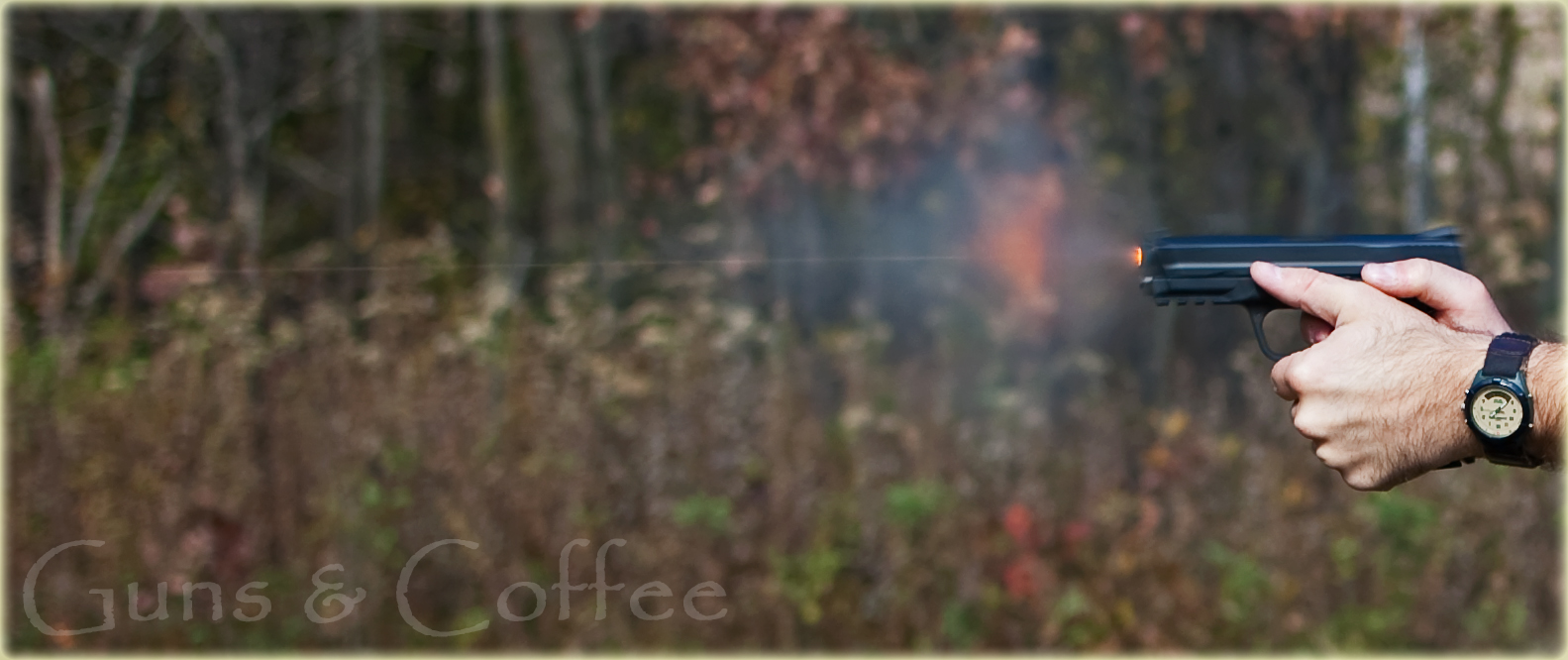

Best I've gotten... actually me shooting and a friend grabbing the camera.
Nikon D40 with Nikkor 35mm 1:1.8G DX lens, 1/500sec, f2.8, iso200.  Sun was at 7 o'clock in reference to the camera, so I think the line is it being reflected off the ball.
Want to get out on a nice bright day with the .45 and see what I can do with big fat slow bullets instead of little zippy 9s.
