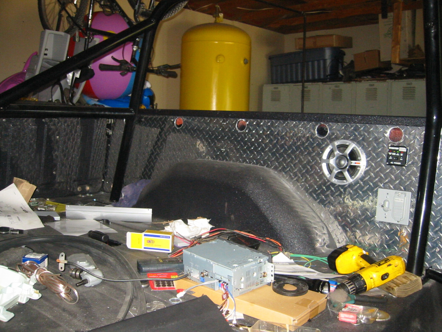

Id like to redo the inside and make some nice diamond plate panels for the back sides, get rid of the thick particle type heavy cardboard that they used back in the 80s.
Diamond plate will be stronger to mount stuff and I should actually gain an inch or two on the sides, cuz its not as thick as what is there.
Here is what someone else did . I really like this, plus you can add panels and even cargo doors, etc. This is the back part of a Blazer
