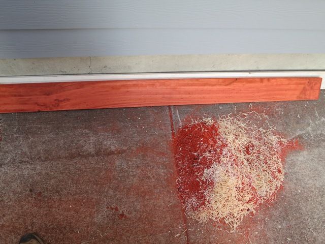

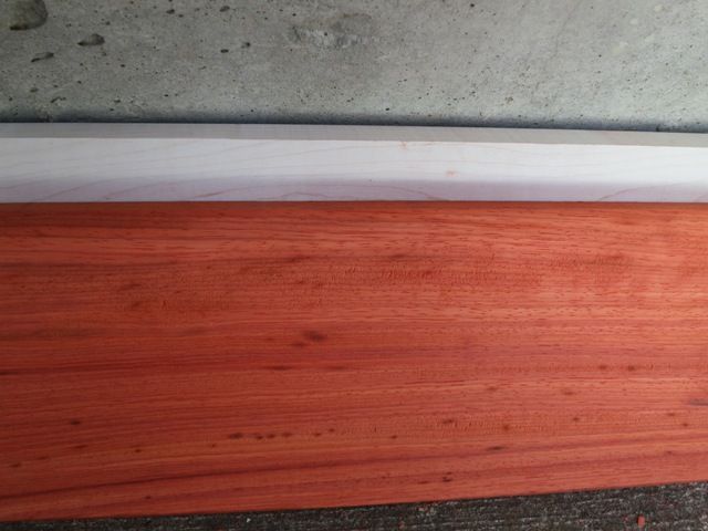

[font=Arial]Here is a pic of my wood.... he he, I initially chose bloodwood and maple but my planer isn't the best and the maple kept chipping out. Common with maple but I
tried it anyways. So my accent color was ash. Planed down to 3/4" which started out at 15/16".
I cut the wood into 3/8 inch strips and then plane to around 1/8" or smaller, as small as my planer can go. I could cut the strips smaller on my table saw but if it
moves at all then the strips won't be consistent, planing makes them consistent for me

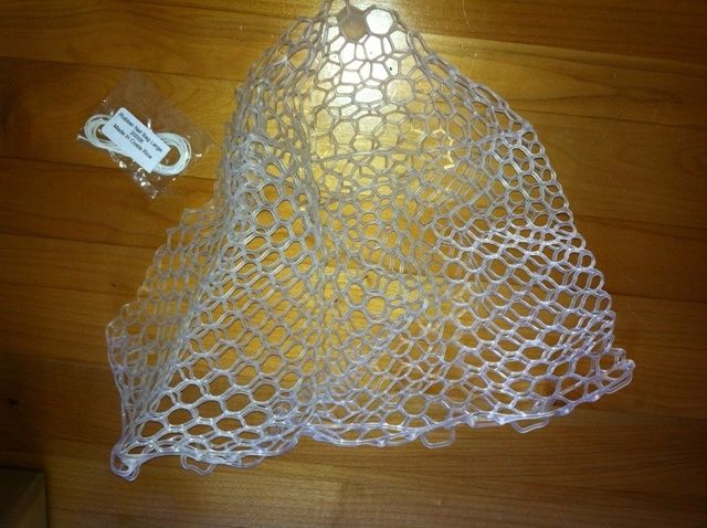

Here is the net I am using, transparent molded rubber netting.

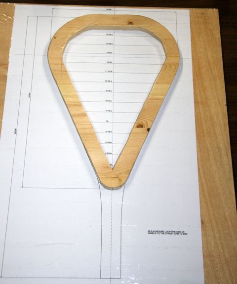

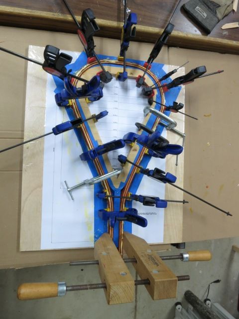

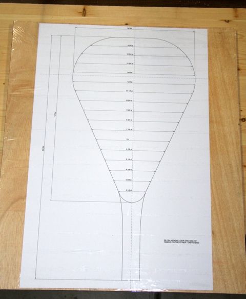

This is the template I use. The net is 2' overall, 1'5" inside length and 12" width.

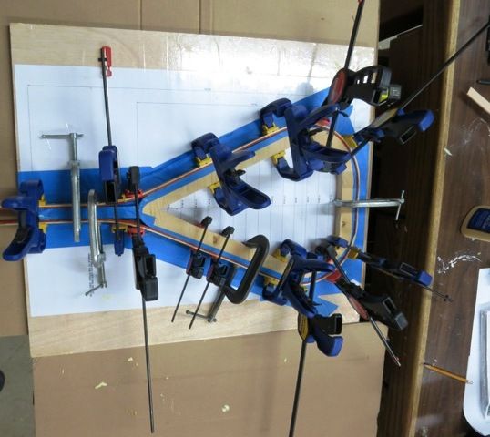

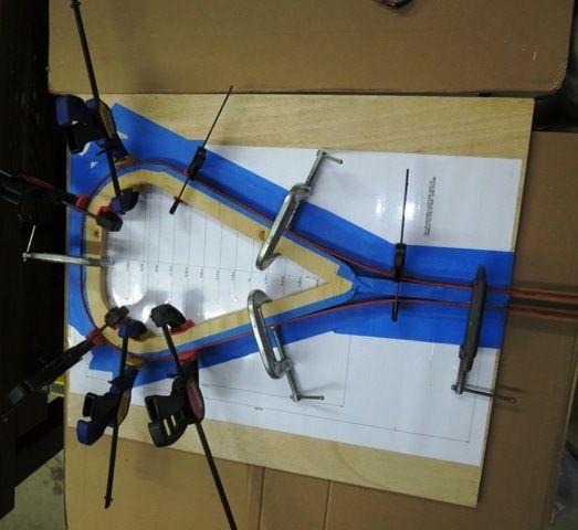

Then I make a form to wrap the strips around. I put tape all over the form because I want to use this form again. So I taped the sheet of plywood and the form to make
it easier to clean the glue, plus you need to tape the form because the strips will glue to it otherwise.

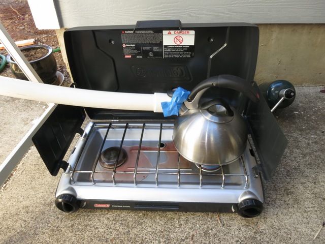

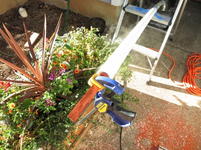

The ash wrap around the form nicely without breaking. The bloodwood needed to be steamed so I rednecked a little steamer together, it worked well.
First strip wrapped and drying in place from the steamer.
First strip of ash in place, all test fitting at this point.

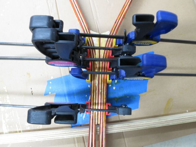

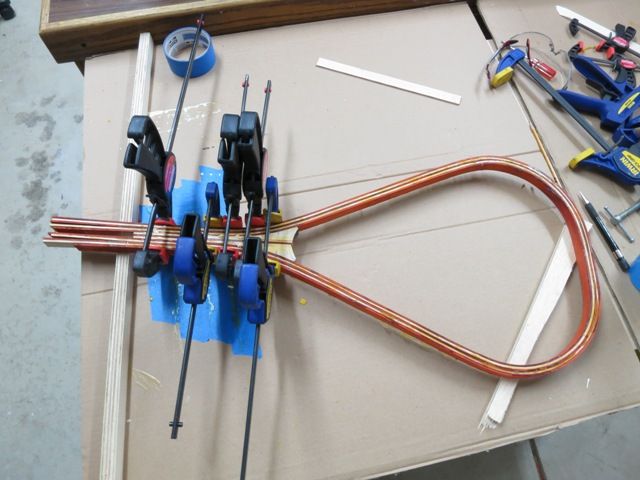

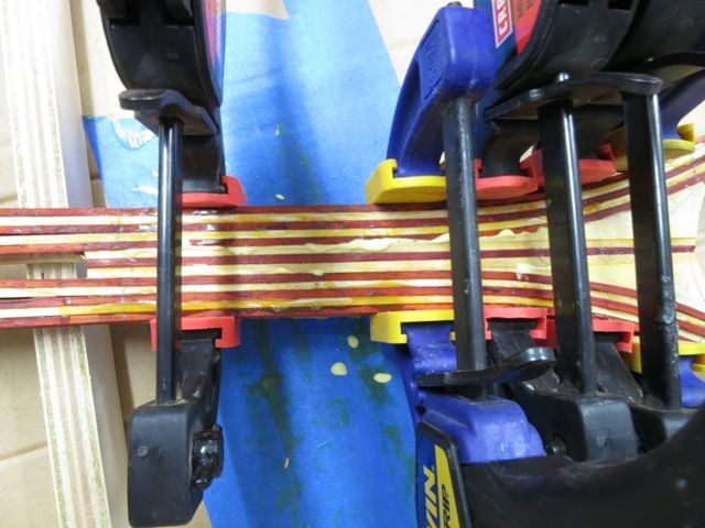

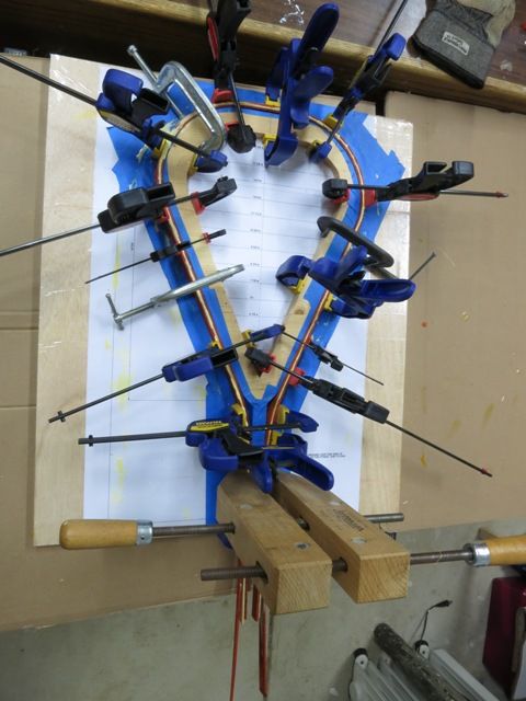

First glue up
All 5 strips in place and glued, I could have used a few more clamps.

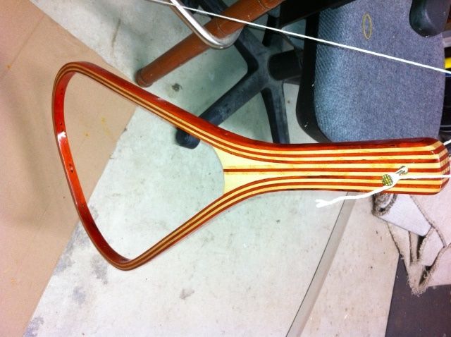

Handle shaped and glued in, I did use the maple on the handle though. I like the contrast of the colors.
So again, I was in a hurry so I missed a few steps in the process so no pictures. I sanded all the sides and handle. I used a satin poly from minwax to finish it.

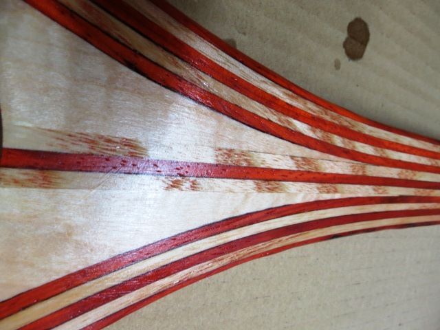

Dried

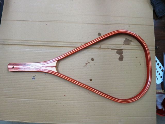

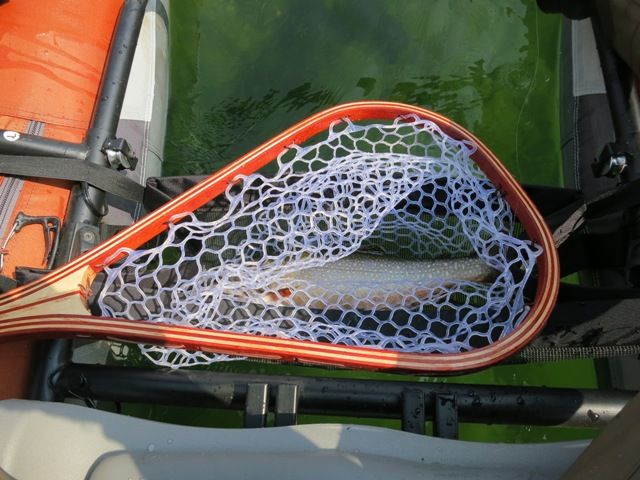

Finished shot of the handle

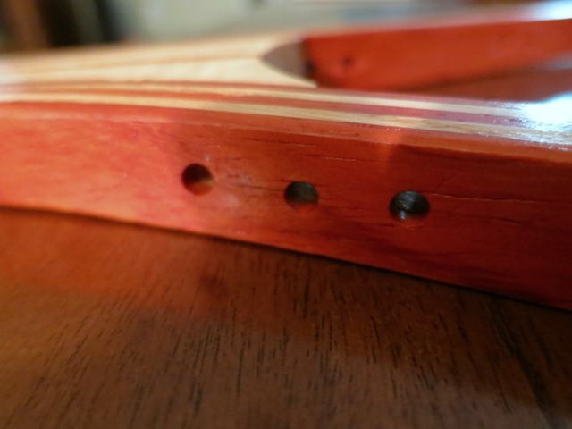

Holes drilled. I drilled 15 holes for the straps and threaded a piece of leather around the net.
Payoff
