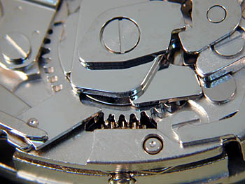

As I said, it depends which part and caliber you're talking about, but often you'll find this on the *dial* side of the watch.
Here's a 7733, for example:
3/18/2015 3:01:36 PM EDT
http://www.ranfft.de/bidfun/katb/2uswk/Valjoux_7733-1.jpg
The OP's watch is a chronograph.
You would have to remove all the chrono complications, date complications, and day complications to get there.
3/18/2015 3:04:48 PM EDT
depends on the watch.
Most of stem setting lever are under the winder and complications . All I have seen at least. I am not master watchmaker.
It's a hobby for me.
The Valjoux 7733 is a chronograph.
It is the base design for the 7750s and many of the ETAs out there.
If it it has day and date wheels you would have to remove them...but that is on the dial side. That is not at all the equivalent of completely disassembling a movement.

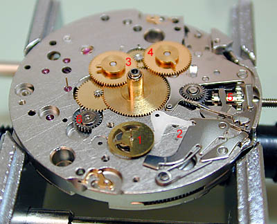

This is from a 2010 post on WUS regarding a Valjoux 7733:
"The little dimpled button next to the stem. Pull the stem into the setting position, push the button and pull the stem free. Re-install in reverse order."
I'm not a watch mechanic, so I can't speak to the validity of the above statement.
3/18/2015 4:36:49 PM EDT
Yep, Dave...I believe you're right.
Here you can see the release button bottom center of the picture on a 7750 automatic variety:
This would need to be pressed again to reinsert the stem and hold correctly.
However, if the set lever broke, I believe you can access it from the dial side alone, as seen on the right side of the frame here:
(Pictures courtesy of TimeZone)
Still, not something someone unfamiliar with movement works would want to get into, but not necessarily calling for a complete service, either, depending on the extent of the damage.
I also found this thread showing the adjustment of the keyless works on the 7750, where you can see how the set lever, etc., could be replaced.
http://www.replica-watch.info/vb/showthread.php/135678-Keyless-work-fix-Part-2-7750
