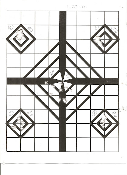

Today I was out tuning up my Savage Mk II-BV (pre-accutrigger).  It's got a no-name 1.5-4.5X scope on it that came with another rifle years ago.  We've been having some raccoon problems (lost two chickens so far) and my FIL got me one of these for Christmas:
So today it was sunny and I had the time.  I went out and shot a few 10-shot groups:
The three groups of interest are lower right, upper right and upper left.  They were fired in that order.  The lower right group is 4.5X at 25 yards.  The upper right group is 1.5X at 25 yards.  The upper left is 3X at 25 yards.  It looks to me like somewhere between 3X and 1.5X the POI shifts down and to the left about 1/2".  1/2" @ 25 yards is about 2 MOA.
I doubt I'm going to trash the scope over it - I rarely shoot further than 50 yards with this rifle and I plan to simply leave the scope at 3X for raccoon duty.
