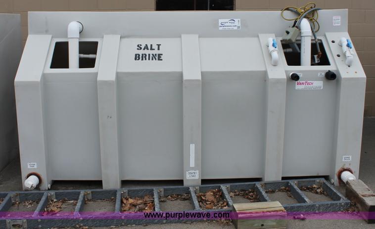

I have a flow rate of 40gpm@60psi. What I am wanting to know is how many and what size hole you can drill in a 10ft section of 1.5'' pipe to maintain full flow and psi. Edit: added pipe size If 60 psi is maintained - then the flow rate remains the same provided the exit area is the same. example: Two .75" inch holes ( no matter where they are located on the 10' section ). Thanks, but, I need to dissolve salt in a 10ft long tank some-what evenly. |
Thanks, but, I need to dissolve salt in a 10ft long tank some-what evenly. Quoted:

Lets see here... 10 foot wide and 1.5 inch pipe.... Hmmmm http://d323w7klwy72q3.cloudfront.net/i/a/2014/20141016kdot/I1392.JPG How many holes in the pipe? Looks like a call to VariTech tomorrow. |
