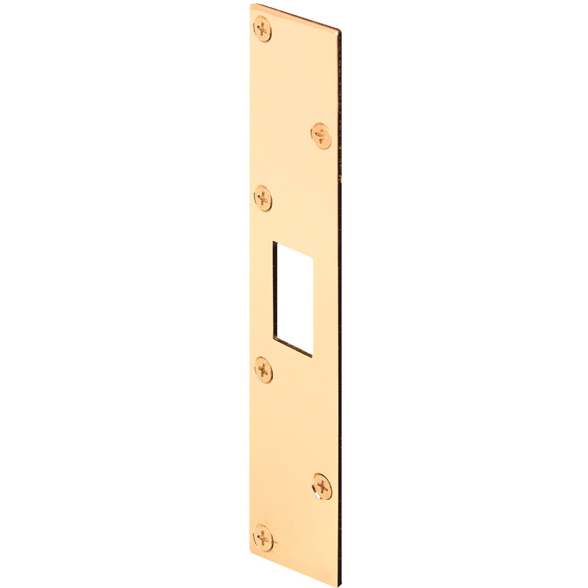

I bought one of these at Lowes yesterday. Not as good as the full door height strike plate but this was only $4, the mail order ones are closer to $100. I think this and the 3" screws it comes with should make it a good bit stronger and it gives me a chance to break out the router.

cache2.smarthome.com/images/5179main.jpg
A roll pin installed through the door pin/hinge is easier. Covered over with paint to hide the roll pin has worked for me.
