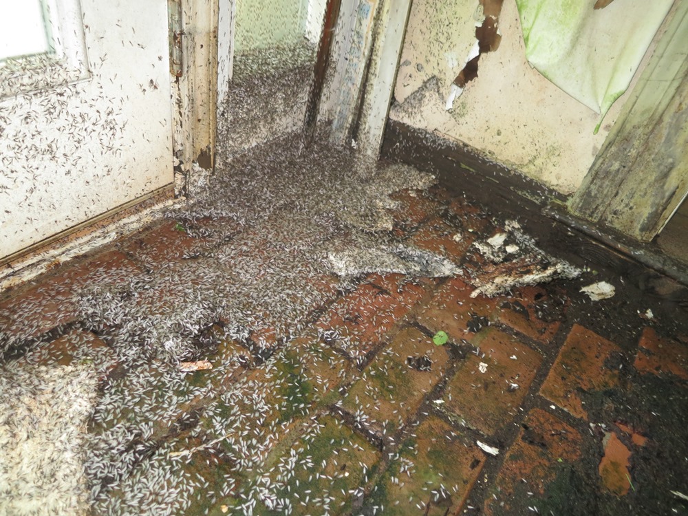

How far will swarming termites go?  Just because they landed on his house does not mean they are in or under his house.  The termites will still want something easy to eat, so is there any rotting or soft wood exposed at the OPs house?  They aren't that interested in hard dry wood.
These came out of the rotting wall in a house I purchased.  Only the wet wood soaked by a leak in the roof was eaten.  The other areas has some termite trails over them but the dry wood was left alone.  I think it had been less than a week since I had closed on the place.  I knew the wall the damaged and saw minor termite activity.  A warm spell after the spring rains brought the swarm out.  Thankfully I had a 4 gallon sprayer already full of water and a container of termite killer from Lowes.  I mixed it quick and took out most of the swarm inside and outside the house.
Even if it didn't really make a dent in their population I still took great pleasure in killing thousands of termites.
