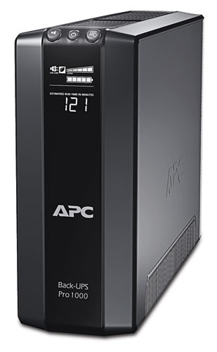

My 10 year old APC UPS went tits up, the battery itself is over $30 - maybe time to just get a newer one with a larger capacity.
What do you people think about this APC model? It has 10 outlets which is really nice, considering I am using a power strip also for additional outlets.
The thing seems massive, it's 19" x 9" x 15" - i have full size Desktop with 3 HDD - 950 watt power supply, 24" and 19" monitors, 2 laptops, speaker system, 8 -port switch, 2 printers and a VoIP.
APC BR1500G BACK-UPS Pro 1500 10-Outlet 1500VA/865W UPS System
or
APC BR1000G 600 Watts/1000 VA
or
CyberPower 1350VA 810W  Pure Sine Wave Tower

I would go the Tripp-Lite direction due to better warranty support, better customer service, and just a better product.  I hate APC, and have seen them shit upon numerous customers, so much so, that our shop quit carrying their products.

Really it doesn't matter.  They are both likely to run everything you need.  If you want you can do the selector on the apcc.com to see what size you need for the load and run time you are looking for.

The 1500 will likely have a longer running time. If you go with the smaller one you risk it being close to your maximum overall load and also a shorter run time.
I personally prefer APC Smart-UPS models. More expensive but more options for longer run time. Also they have true sine wave output.

If you go with the the apc 1500 you can also purchase the extra battery pack.
Battery Pack
I have this set up running at two of my client sites and it's been really nice.
