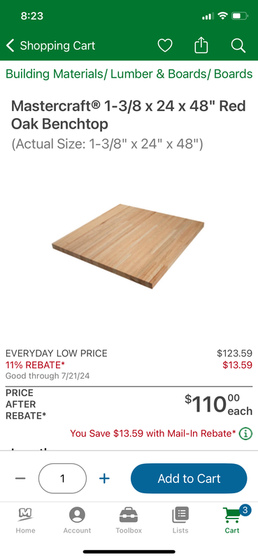

| Haven’t started bench yet- am I overthinking it? I do want it solid- and would like the top to be smooth. I have seen the double plywood-and the solid core doors- and even 2x6 or 2x8 butted up next to each other. There is also some 1-3/8 solid boards for top. Was gonna make a 4’x25” smaller bench- and a 6’x25” bench both with same style- was just thinking the top like a sheet of ice and clean top. |
