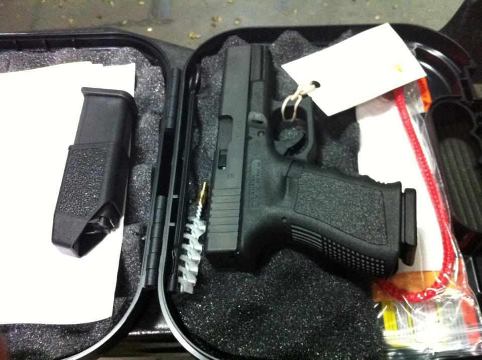

I recently bought a brand new Gen3 G19. Serial number is RXxxxx. Test-fire date was July 2011.
I became a little uneasy about my purchase after reading about all the ejection issues the Gen3 G19s were having.
Today was the first day that I was able to make it out to the range and test-fire it.
I fired 100 rounds of Federal Champion 115gr and 100 rounds of PMC Bronze 115gr. I meant to bring a box of Winchester Ranger-T but I forgot to bring it.
The second round of Federal caused a stoppage. The round had been engaged by the slide but failed to enter the chamber. It seemed to have been hung up on the feed ramp. I was able to easily clear the stoppage and resume firing. I believe that a factory-fresh recoil spring combined with weak ammo may have caused this.
The other 198 rounds were flawless. I consider the early stoppage to be a fluke that could have been caused by any number of things.
My shooting buddy and I took turns shooting the pistol and observing the ejection pattern. The pattern was slightly erratic but was generally in the 3-to-5 o'clock direction.
I've read stories of recent-production G19s having stovepipes and consistently ejecting cases straight back into the shooter's face. My recent-production G19 did not have these issues.
My range experience today set my mind at ease about my new Glock 19. Hopefully it does the same for you.
