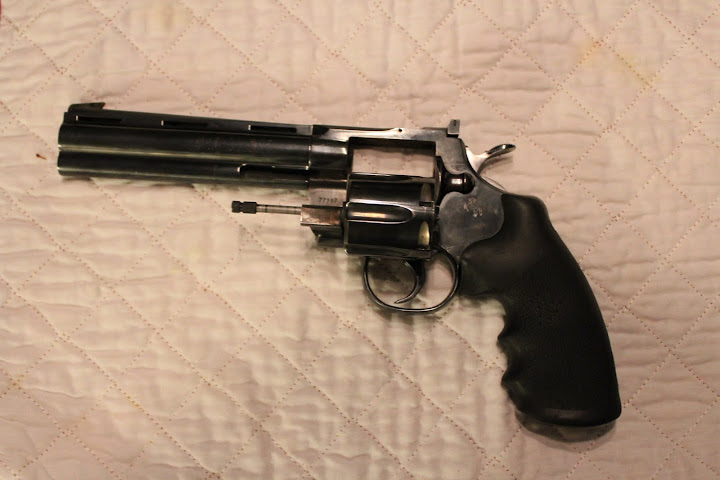

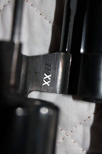

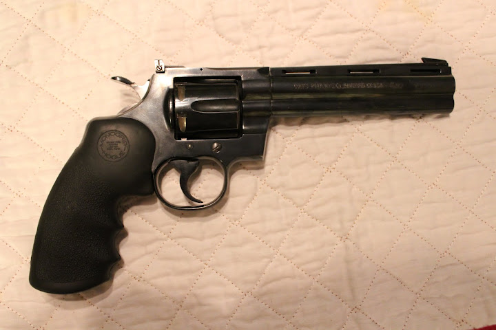

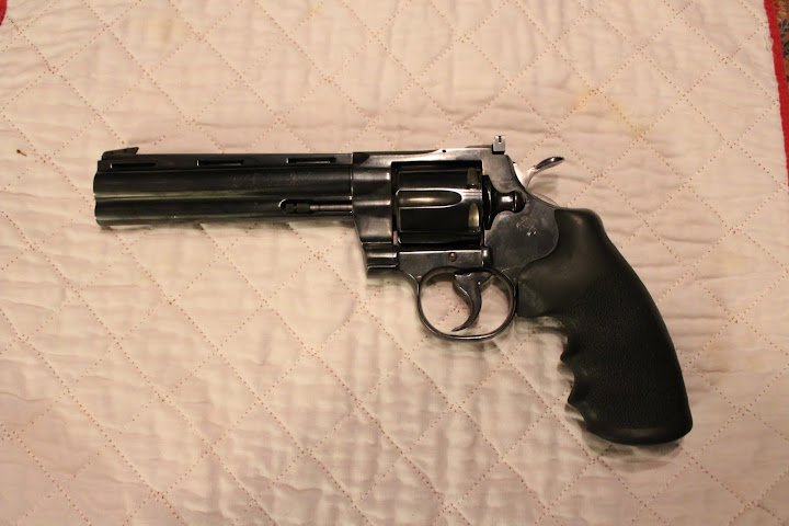

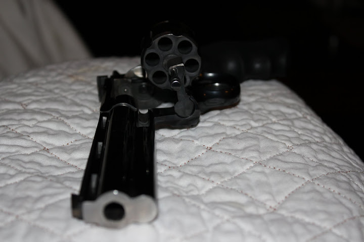

I intend to leave it alone. I picked it up on Friday, cleaned it up a bit after shooting (and it's dead-on balls accurate) and took some photos. I'm over at ColtForum looking for advice on this as well.
http://www.coltforum.com/forums/showthread.php?t=29532 Pics will be up soon, just gotta upload them tonight. |
