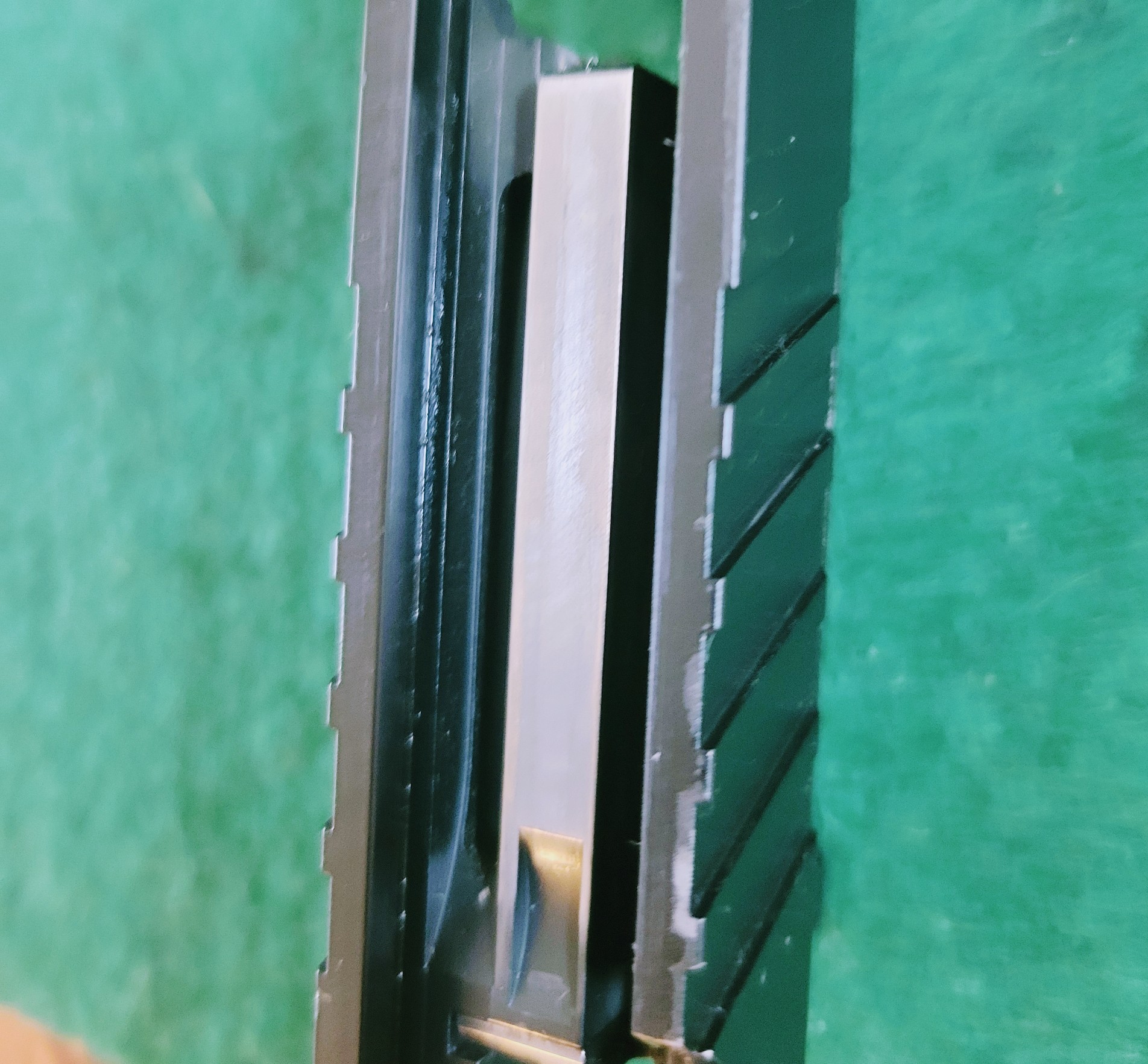

Shit I bet that's what was stopping my EGW extractor from going in.  Gonna check on that later.

5/27/2023 5:53:46 PM EDT
Originally Posted By Kuraki:
I would love to see a pic if you get a chance.  I've never seen anything like I think you're describing.
The extractor channel cut appears factory. I'm still puzzled why SA went this way.
5/27/2023 7:04:14 PM EDT
Originally Posted By leelaw:
https://www.apt401.com/ProdigyCut1.jpg
https://www.apt401.com/ProdigyCut2.jpg
I don’t think SA did go that way. That is the only sample I’m aware of that was cut like that. I’m still thinking that was bubba smithed to lighten slide weight.
5/27/2023 7:58:33 PM EDT
Dunno what to tell ya other than I was told the pistol was stock, the millwork and finish is consistent with the other internals, and I believe the guy.
5/27/2023 8:58:07 PM EDT
[Last Edit: SilentDeath12886][Edited] [#17]
Bought my Prodigy 5" about 2 weeks ago. Brand new.  The window is cut out so I can see the extractor very clearly as well.
Since my slide is currently stripped, I can see the screw that the cover plate.  It does protrude significantly into the holes and I could see how a screw would impede a proper install of an extractor if its just a hair to long.
5/27/2023 9:19:09 PM EDT
Interesting. Maybe it’s from more recent runs. What is your serial number range?
It’s been a long held belief/understanding that 5” isn’t the best slide length for 9mm in the 2011 platform. That’s why most are around 4.4” and/or the last inch or so is either a sight block or built in compensator so that only 4.4” or less of slide is actually moving under recoil.
I assume SA is doing that to try and remove weight to help the slide function. Seems like a bad place to cut considering how much carbon would likely get into the extractor channel and eventually cause malfunctions by limiting the extractors ability to flex. However, window cuts in the exterior of the slide could allow for debris to get into the action and cause malfunctions as well. Though, as a customer I’d prefer slide cuts to lower the weight over what they seem to have opted for.

5/28/2023 10:22:23 AM EDT
[Last Edit: -CRW-][Edited] [#20]
Standard extractors will fit. It’s the oversized extractors that run into the screw like the EGW HD or the EGW Practical with its larger locating/centering bulb.
And if it’s a slide weight savings measure it would make sense to do it on the 5” and not the 4.25”.
5/28/2023 7:34:31 PM EDT
I was able to drop an EGW Practical into my 4.25 without having to touch the bulb up... but the only vertical screws are the plate screws for the 509T optic plate.  May well be a different story if I swap plates to the RMR plate I have laid back.
I get the idea of slide weight cutting... but it seems odd to open that extractor channel to debris to shave a gram or three of metal out.  They could have notched the cocking serrations forward and rear a hair deeper and gotten the same savings and not had that channel open.
I may grab a 5" here soon as I'm enjoying modifying the 4.25"... but If that channel is cut open on the current models, I may have to wait for more feedback on any issues it could manifest.
5/28/2023 7:52:54 PM EDT
No clue as to why you didn’t have the screw issue. Maybe it’s the different plate or maybe it’s another change SA has implemented. Several of us in the big Prodigy thread had the same problem and it was in both 4.25” and 5” models. But I believe it was all with RMR plates.
So weird. Thanks for sharing.
My 5" has the cuts as well. # 13952
7/3/2023 8:54:40 PM EDT
What’s really is odd is my 5” does NOT have them and it’s serial number is 14xxx.
What’s really odd is my 5” does NOT have them and it’s serial number is 14xxx.
Even more interesting is that I just bought a used prodigy that is 01xxx and it too has the cuts...Now I am confused unhappy and don't know if I'll be having the DSX conversion completed.
7/5/2023 8:48:21 PM EDT
Despite my serial number being over 14k, my 5” was bought the day the Prodigy was released and picked up the next day.
