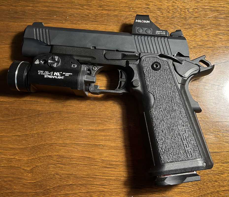

Lights;
The TLR3 fits great.

So with some internet help I was able to fit a TLR-1 onto the 1911 DS carry.  It requires modification of the P320 key.
Here is the unmodified key, I added silver sharpie to the area that needs trimming.
I tossed it on the mini mill and shaved it slightly into the lug and judiciously sanded for a tight slip fit.  You do have to remove the front lug as it interferes so that may add another step if you decide to swap this between pistols.
I did not try this mod on other pistol rails yet.
