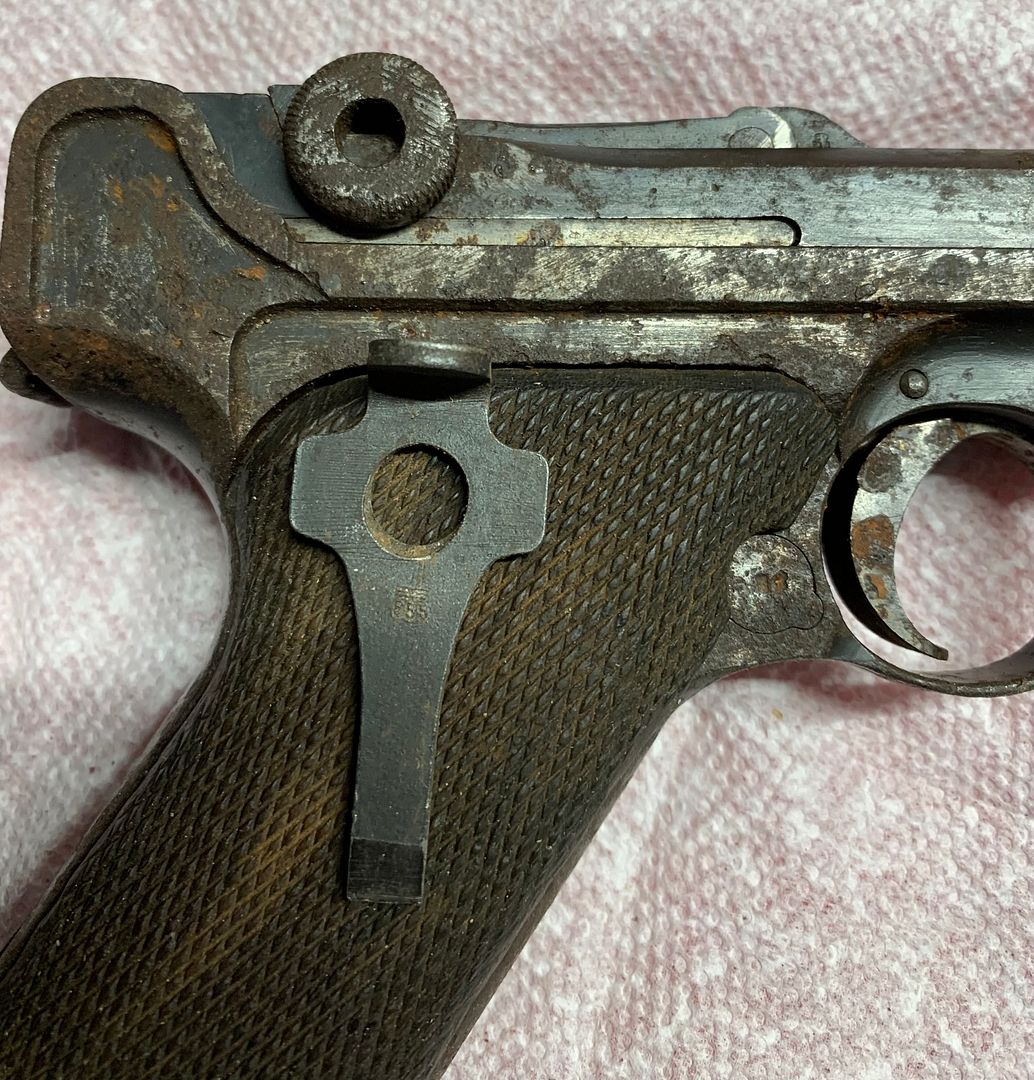

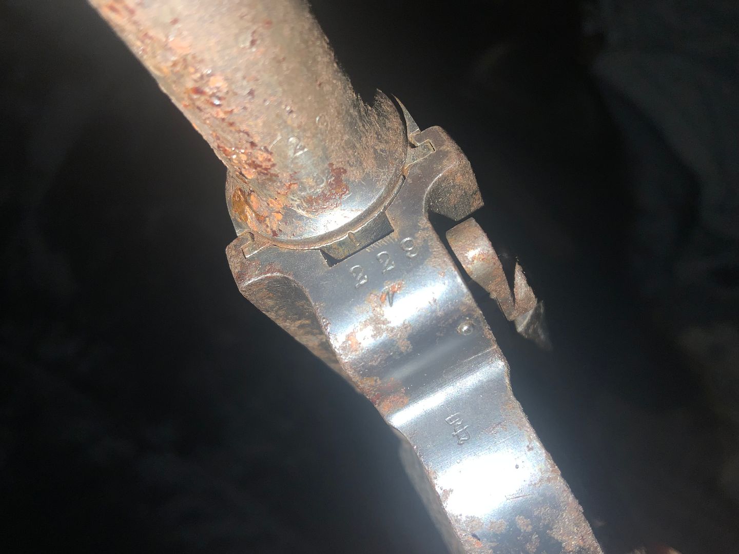

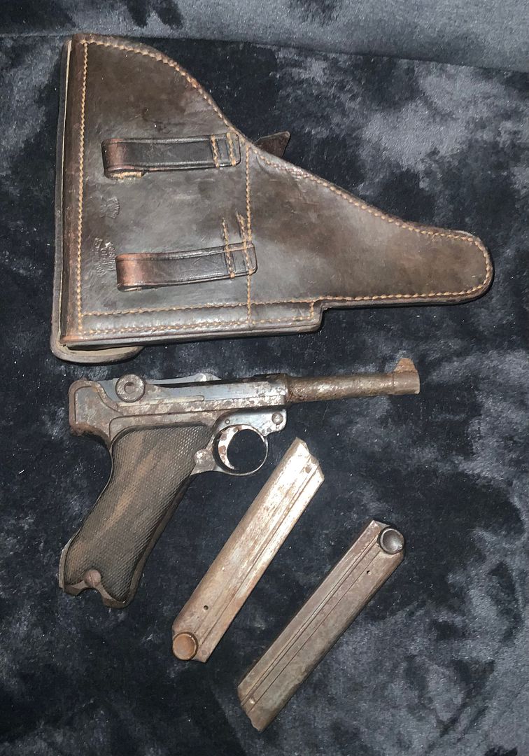

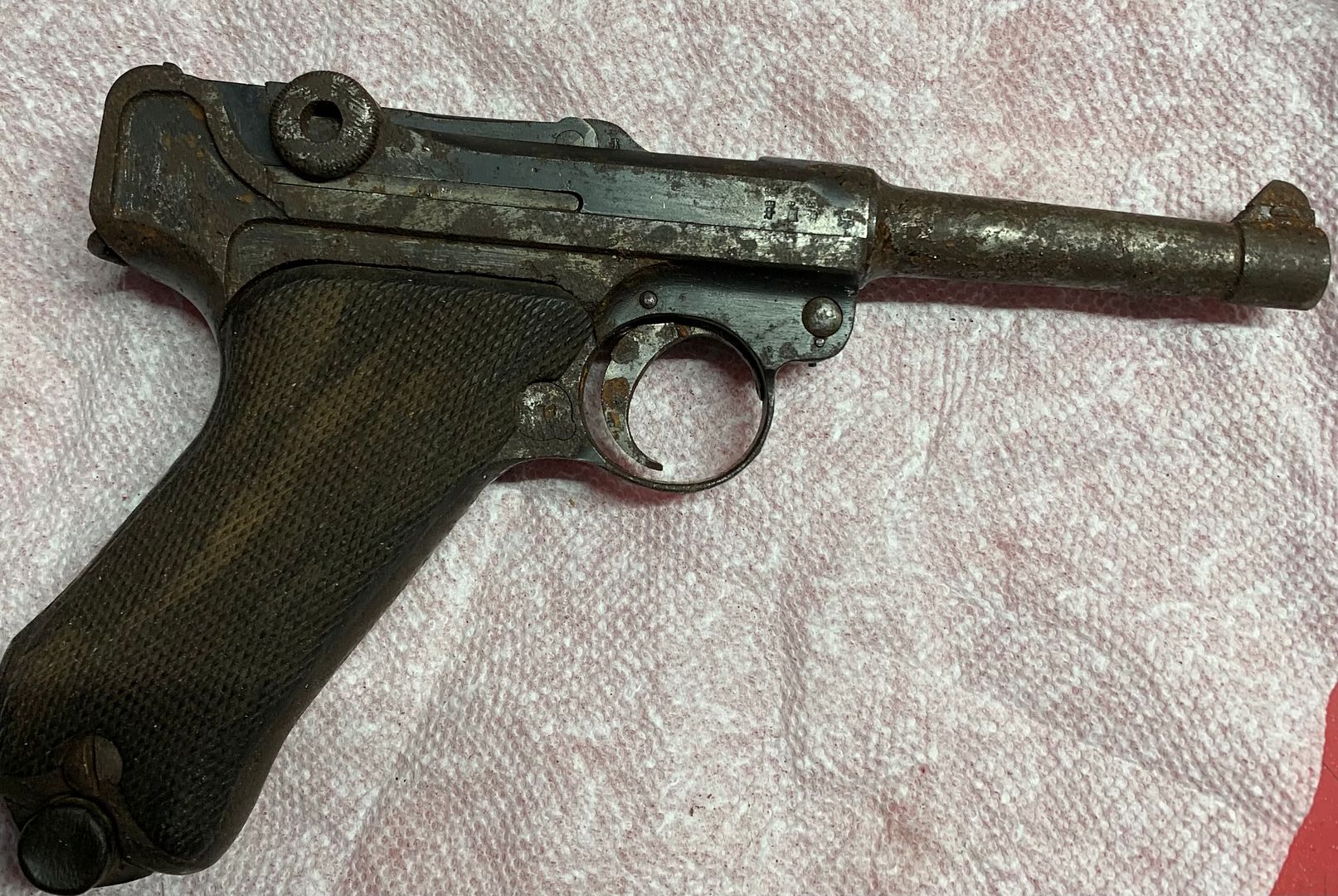

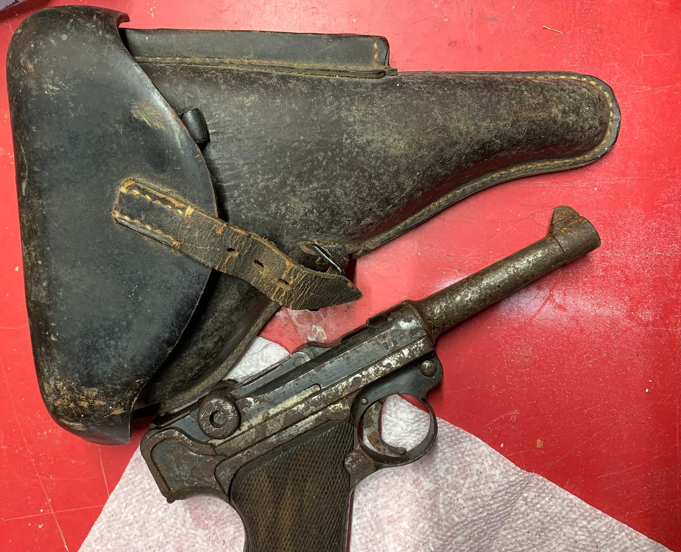

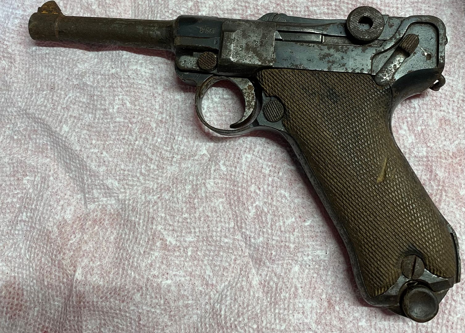

And I just got roped into a full restore, as apparently 1915 DWMs don't grow on trees
Oh well, so long as I can take the thing out and shoot it now and again... |

That's beautiful.
Death to quislings.
How much did that run you, if you don't mind me asking?
I have a 1918 that I want cleaned up. |
