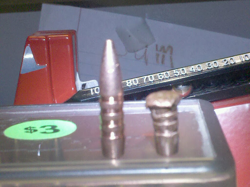

this probably isn't exactly what your wanting to know. but I just used some of the Barns 70gr TSX on a hog hunt at the beginning of May. out of 3 shots on hogs, 2 were through and through and I did not recover the bullets.
the 3rd shot we did recover the bullet. and even after passing through the shoulder blade and that thick ass shield hogs have, it came out weighing 53.6gr. The first shot I took was also a shoulder shot and it demolished the shoulder blade and left a decent exit wound.
the load I used was 24.5gr Varget, new Winchester Brass, CCI primer and the 70gr Barnes TSX boat tail.   and that was out of my 1:7 18" barrel CMMG AR.

no, actually that is good to hear.  did it tumble at all or just poke straight holes?
the through and throughs were straight holes,no tumbling at all that I could tell. here is a before and after pic for you on the one we found.
looks like the pedals just sheared off after expansion.  I can tell you on one of the other shoulder shots it was so mangled we had to throw it out. Wasn't even worth keeping. (the shoulder, the rest of the pig was fine. in fact the tenderloins were great )
now that is interesting.  in the ballistic articles that i linked it said that the barnes bullets weren't the best choice for autoglass since the petals tended to sheer off
