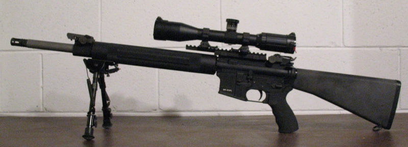

It all depends on what your intended use is.  Heavy Barrels are just that: Heavy weight.  Bull barrels could be considered "Super Heavy weight".  My wife's precision rig has one, and the whole thing with optics weighs in at about twice what a "normal" rifle should (15+ lbs instead of 7.5 or so).  It never leaves a bench or it's bipod, as it is a specialty rig for long-range (300-600 yards).

BTW, exactly how thick is that "bull" barrel?   It looks rather like a 16" HB with no FH.  Bull barrels are generally .9" or better in diameter.
ETA a comparison pic:
A Bull barrel should have a diameter even greater than a standard A2 flash hider.
209.200.109.169/arfcom/Ao_rig.jpg
