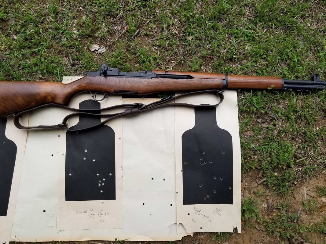

Since we went GD quality in thisthread all of a sudden, i agree!  Which is why won't touch .308
When I shoot .30 cal, I shoot proper 30-06 .30 cal.
Every deer I have taken has been with that rifle.  Well, except my last one, where I skipped the transition technology .308 round and went right to using modern technology decades proven and common 6.5 Creedmoor.
