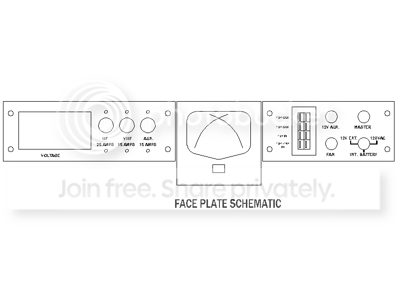

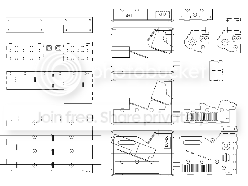

Finally getting around to starting/finishing my communications box.  This isn't a traditional go-kit or emergency box in the form that some may need.   I will be using this box frequently, will be taking it with me when I go out-of-town, weekends at the lake, etc.   So, while it needs to have the function and emergency features of a go-kit, I would also like to add a little more flexibility.
Given that it will also be my emergency communications box, I also want those back up power features and am planning on a few.
Power Planning:
On board 12V power.  This will be a light weight sealed lead acid battery.  I am not anticipating it being able to provide more than limited service because I don't want that kind of weight built into the box.  When I need full service, I'll get that external.
Off board 12V power.   This will be accomplished a number of ways.  First, a simple Anderson powerpole attachment to a 12V power source.   Second, there will be an on-board DC-DC converter to handle higher voltages from external power sources, such as the 18 to 24 volt lithium batteries.
On board Power Supply.
I have attached images of the proposed wiring diagram and the proposed face plate.
I have the box.. the picture below isn't the exact box.... I couldn't find the picture of the right one, but it is very similar.  I'll take a picture and update.
Basically, a clamshell hard plastic container that is substantially waterproof.. no wheels on mine... it measures around 18 inches wide 12 inches deep and 10 inches high... everything does fit... but it has taken some planning to get everything in... yes, it is all vented....ample air movement has been thought through.  This case, however, will not pass the Jedi bathtub submersion test... but, it is sufficiently waterproof for my purposes....
The plan is to make the framework and face plate by cutting the parts out on a laser cutter engraver, which I do have....  All of the frame parts are drawn out on autocad and cut in the laser.  The face plate will be cut from white acrylic and then painted.   Once painted, it will be put back into the laser and the paint will be burned off revealing the white acrylic below exposing the lettering.  Some of the frame diagrams look like this...
Not sure how well this screen shot image will show up, but once I post so actual picures it will be more clear.    On the face plate, the center box is a small SWR meter... I was going to have a switch to turn the on board battery charger on and off, but I ran  out or room when I added the SWR meter.
Anyway... before I start burning parts, I would appreciate you guys helping me think through this one more time to make sure I haven't forgotten anything important....  I am sure I will forget something...  but hopefully nothing too critical...
The second phase of the project will be a small portable antenna bag... but, we aren't there yet....
Thanks in advance for the input...

I'm not sure that I fully understand all of your diagrams, but here are a few thoughts:
Accessible fuses or circuit breakers?
Convenience 110 VAC outlet(s)?
Bring all rear-panel radio connectors to front panel?
Mic brackets?
Separate broadcast/EAS/WX receiver?
ETA: Also storage for radio manuals? I'm not a Yaesu user, but my experience with Icom rigs is that they have so many features that I use only rarely that I often forget how to do certain procedures, and so it helps to have a manual on hand at all times...

"Not sure how well this screen shot image will show up, but once I post so actual picures it will be more clear. On the face plate, the center box is a small SWR meter... I was going to have a switch to turn the on board battery charger on and off, but I ran out or room when I added the SWR meter."
Why not consider using 3 position center off toggle switches for more functions in less room?
[Also, are laser cutters of 1/8" aluminum capacity, used, available at reasonable $ in the present economy?]
6/20/2010 7:53:56 AM EDT
Did not think of that... thanks...   I could probably join up the charger and the fan on the same switch... just could not run them both at the same time... don't think that should be an issue...
I am sure there must be...   have been thinking of selling mine   :)   Mine is only a 40W laser, not sure it would cut 1/8" aluminum...    probably need something approaching 100W for that.  Waterjet cutter might be a better option for cutting metal....
Thanks again for the switch comment...   That might just solve the issue

Unless there's some danger of backfeed into the power supply devices, could you reduce the 3 and 2 position switches to a single 2 position "Power Supply" and "Battery" switch?
Power selector switches can fail.  Jumpers might be an interesting/cheaper way to go.  Or at least as a backup, inside the unit.

Got some test panels cut out tonight...   several issues that need to be corrected...   Not sure how large these pictures will be... but I'll downsize them tomorrow if they are too large...
The preliminary glue up of the frame...   the idea is that this frame work holds the components.  It is lowered down into and bolted to the plastic carry box.  If anything needs to be worked on, the entire frame can be lifted out of the box... well... that is the idea...
The drop'd space to the right side of this picture is where the SWR meter will sit...
I did a ruf sample on the face plates... painted the white acyrilc black... not sure yet what color I want the face plates to be...  suggestions?  The carry case/box is black... I was thinking red or dark blue....
Want to let the glue dry and try to mount some radios and stuff to this sample before I cut the real parts... but... making progress.
yes.. yes... the text will line up correctly on the final version....
http://i585.photobucket.com/albums/ss300/mndless/box1.jpg
http://i585.photobucket.com/albums/ss300/mndless/box2.jpg
http://i585.photobucket.com/albums/ss300/mndless/box3.jpg
http://i585.photobucket.com/albums/ss300/mndless/plate1-1.jpg
http://i585.photobucket.com/albums/ss300/mndless/plate1.jpg

Test fit has a good many issues...   sequence of attachment issues, not enough room issues and some simply got it wrong issues...
Or use a rotary switch.
1, 2, 1+2, etc.

Updates... have made progress on the radio support frame...  I am on test cut #3 and I finally have it fitting properly within the plastic box.   There are still a few issues I have noticed, so we will at lease have test cut #4 before the final.
When I got everything fitting in the plastic box I noticed a couple of things... first, the back of the radios is not readily accessible.  So I opted to install some remote jacks on the right front... this includes the external speaker/headphone jack, the CW/Key jack and the data jack.
I also noticed a space between the two radios where stuff might fall down into the box.   Installing a blocking plate took care of that and also gave me a place for 2 more switches.  So, I am placing an on/off for both the power supply and the battery charger there.  I want to be able to leave the box plugged in and run either of those two without the other... which requires a switch.
Anyway, paited up a test sample... I like the orange, but it lacks contrast on the lettering of the white acrylic... so...  will keep testing some options...
Sorry for the picture sizes...
Going to start working out the routing of wires next....
